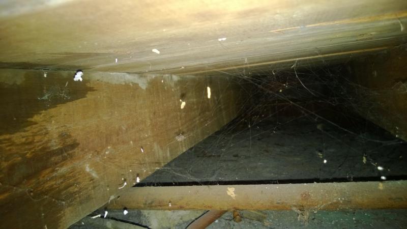

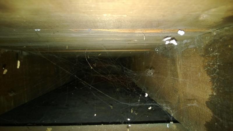

I have just started planning my new bathroom and found extensive woodworm holes and damage in the floor under the old hot water tank (now gone).
It seems to have been there for a while as someone has previously nailed a bit of wood to the most damaged beam to support the floorboards.
Is there any way to tell for sure if its still active and what do I need to do for peace of mind?

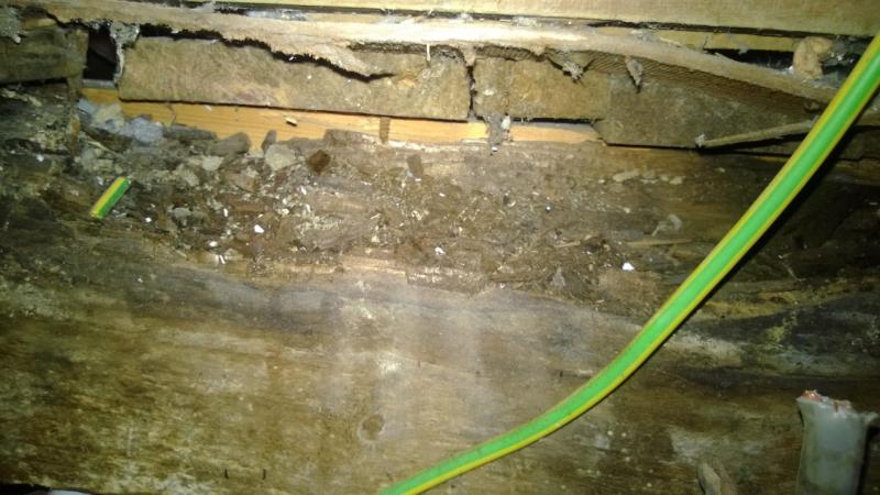

The floorboards above are full of holes and there was a small white carcass stuck to the side of this beam.
looks like there has been some sort of treatment sprayed/brushed onto the timbers as there is brown staining??
cant really tell how bad the joist is in the 1st pic with the board pick up?
but as its underneath an old tank,experience suggests there may of been a leak and it may be a touch of old wet rot?
cuprinol 5 star treatment and use a small garden sprayer,for small jobs i use a spray bottle.
Definitely lots of little worm holes in the wood - will the cuprinol kill it off? Looks like the wood in that area has been treated, as you point out its a different colour.
House was built in the 30s so it could be from any time.
put some white paper under the area you think is most infected and give the joist/boards a tap,if you see any frass then it may well be this years infection??
but google 'woodworm'iirc they migrate out of the timber around may to august?? been a long time since i can remember this info.getting old. :LOL:

If there is fine wood dust (like flour) chances are it may be active, usually spraying washes any old stuff away.

Chances are then you are OK, but only way for peace of mind is call a woodworm company for a free survey, however they do have a vested interest in finding stuff to treat :D

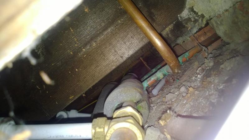

woodworm likes wood that is not completely dry, so most modern centrally heated houses don't seem to get it.
in the position you mention, I suspect a small, long-term leak made the environment moist enough to encourage them. Make sure it is dry, and then the hot pipes will make the timber even drier so they will not survive.
If there is a lot of damage, you may need to replace or strengthen. A cylinder is very heavy. Spray anyway.
If you vacuum away all dust, then any new frass will be easy to spot.

Thanks for the reply, like i said theres no white power right along the beam at all and its a long beam dont think theres enough to warrant replacing it and im sure the home report would have highlighted this as a major if it was, actually just read up about the cuprinal 5 star and the data sheet doesnt sell it very well, think ill brush some on the infected bits instead of spray (im an ex car spray painter so used to spraying stuff thats pretty harmful ), dont want to kill off the fish or the cats :eek:
oh and just to add john the new boiler pipes are just at the back of it so as you said itll keep it nice and toasty and dry
