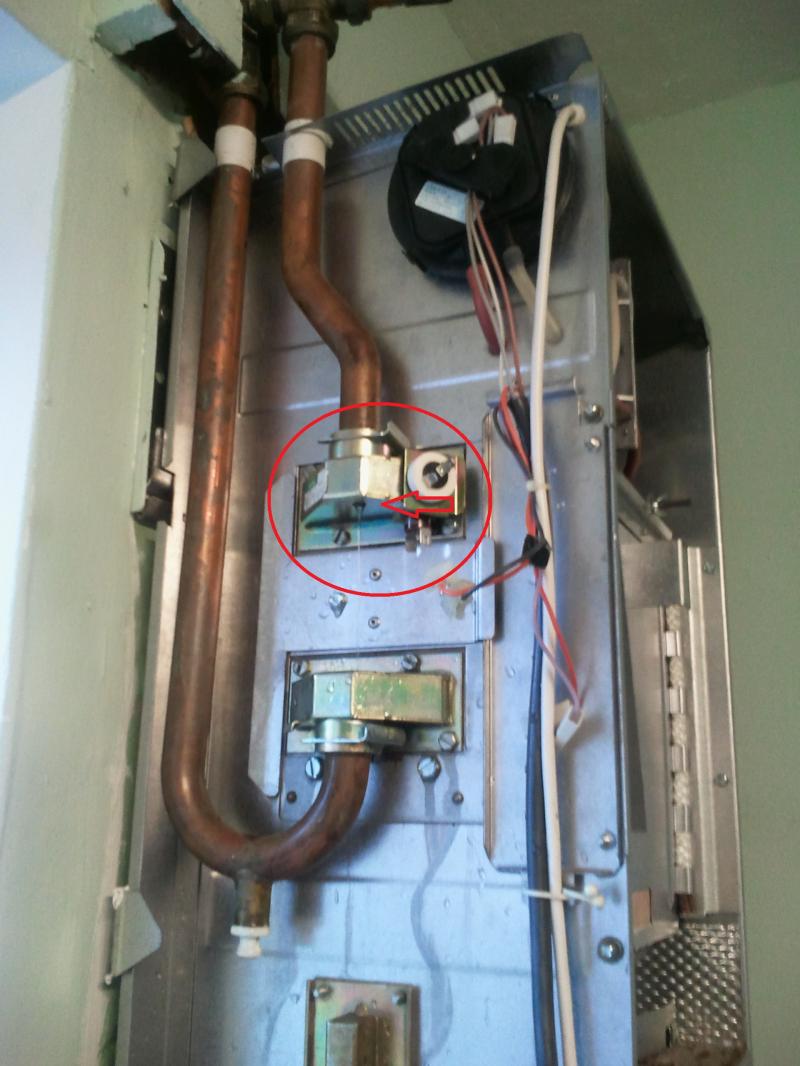

hello guys. the boiler on the attached pic has a leak/hole on the part indicated with a circle. the hole is indicated by the arrow.
can someone please tell me what this part is called and approx how long it will take a expert to replace?
ps. silly question. is there any way of plugging the hole?
thanks in advance[/img]
They are the heat exchanger manifolds. Drain the system, put the case back on and call a pro in. 4 hrs work.
