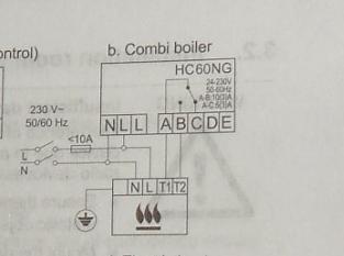

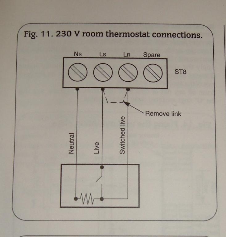

I've got a Worcester 24 CDi combi boiler and am looking to fit a Honeywell Y6630D1007 wireless thermostat. Little confused by the wiring diagrams so was wondering if anyone could help.
This is my boiler:
This is the boiler wiring diagram:
and here is the thermostat wiring diagram
The boiler has a clip connecting Ls and Lr to it.
Any help on where the wire need to go would be much appreciated.
Chris
After doing some research I think I have figured out how to wire it.
Boiler - Receiver
Ns - N
Ls - L
Lr - B
Link L and A in receiver
This would mean I only need the one 3 core cable and don't need to touch the live and neutral on the boiler.
Could anyone confirm this is right? Or do I still need to wire the receiver to the fused spur switch or the live and neutral from the boiler.
