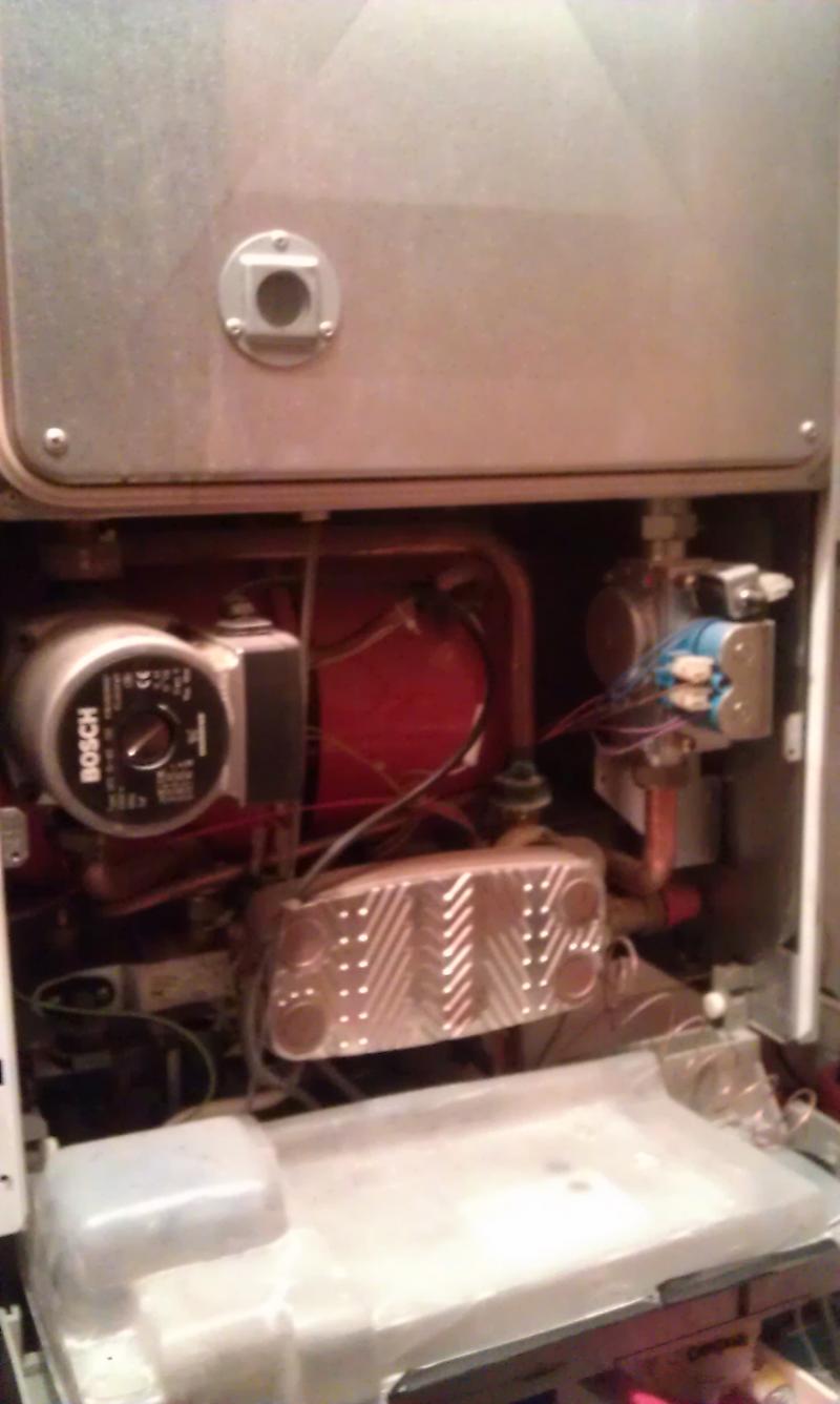

My Worcester 24CDi combi boiler has started cutting out after a minute or two of running DHW. If you stop the tap and restart after a short break it will repeat again with a supply of hot water for a minute or so.
Any suggestions what I should look into?
Other threads suggested a partially blocked 2nd Heat Exchanger. So I had a look without taking it apart - see photos:
I would like to try and clean it out but would need some guidance on how first.

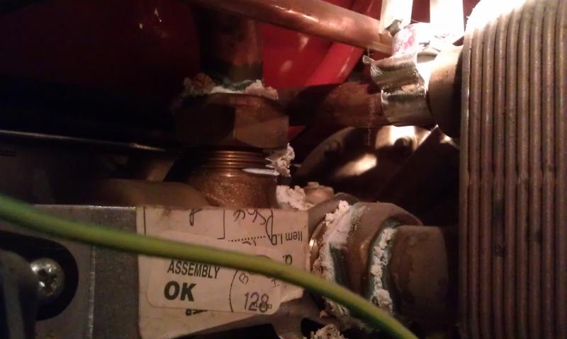

Do do the areas of limescale at the joints suggest build up inside?
Thanks in advance.
No, those suggest..... leaks!. They can be inconsequential though.
The bad stuff in the heat exchanger isn't limescale, it's dissolved radiators, aka rust.
The way you've described the symptoms isn't typical, but a blocked hex is so common on a combi a few years old it's worth going in there first
The mfrs instructions do cover it, and this isn't a hard one, except that Worcs CDi's tend to leak once disturbed.

Is it possible to flush the hex?
When the hot water tap is running and it goes cold, does the red hot water light on the front of the boiler stay on or go off, if it goes off its most likely you diaphragm not a blocked plate
The red light goes off along with the flame.
Also, it seems to be more of a problem with upstairs taps and shower - downstairs is often ok.
Still sound like a diaphragm problem? If so does it need replacing or cleaning??
