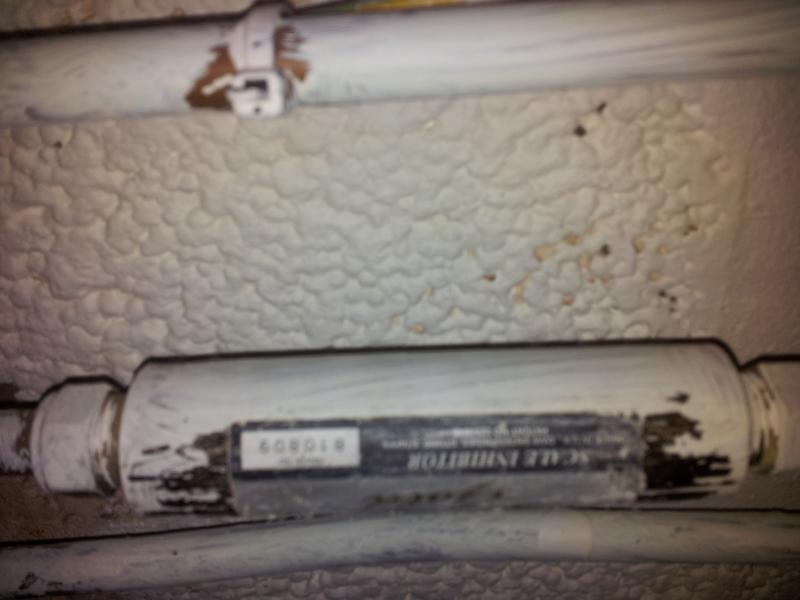

This is in my girfriends flat, think was put in about 2003. Over the last few years the pressure on the DHW has dropped by about half (still just about useable for shower) and also the water temperature is very high due to this slower flow (no adjustable temp control on these, set by boiler I think)
I’m thinking is probably the heat exchanger scaled up – we live in a hard water area (sw London) and the hotter the water this will keep getting worse.
The service manual above mentions a flow restrictor and also a gauze filter in the flow switch – is it worth checking to see if these are blocked, or remove the flow restictor? – is this a simple enough job? My worry I have read with these boilers is that it is hard to get a water tight fitting again due to odd/rubbish fibre washers used!
Really this should be sorted for her – it is a housing association flat, but the contractors who came out just said the flow is okay (despite her making the point that it has reduced by half, the water is almost scalding hot and this will get worse) – she isn’t very technical and couldn’t say much (I work away in thr week so wasn’t there) – he reassured her he will improve it by “increasing the pressure” i.e. in the heating circuit!!!!
How much would someone charge to descale the heat exchanger properly? SW London prices and all that : (
I know she shouldn’t have to, but anyone who has dealt with council/social housing providers knows that unless something is exploded they don’t worry too much about efficiency and it is hard to get them to do anything – even if I suggested it needs a descale, doubt they would do it till water reduced to a trickle.
My other thought is that there is a “scale inhibitor” (looks like made by daw enterprises from what I can see) on the boiler water feed, could this be blocked/restricting flow? I attach a pic – any thoughts? Someone has painted over it helpfully.
Don’t know anything about them, or if they need to be changed/replaced peridically.

So this is for a housing association tenant who is going to pay for the work?
It would be unusual for the boiler to be lime scaled up UNLESS there were dripping hot taps. Where there?
In my area I would charge about £175 but its messy and easier where boiler is not fitted too high up.
Tony

There has been some leaking taps over the years but these have been fixed in reasonable time.
I thought scaling in hex was common in hard water area with this model. But it could be corroded gauze filter or flow restrictor on the water flow switch?
Boiler is in bathroom cupboard at waist height.

London water is not particularly hard and does not cause any problem to boilers unless there are other factors involved like leaking taps!

I had a look at the cold water inlet valve yesterday. Yes it is not fully open, but it has never been touched or adjusted in the years my girlfriend has lived at the flat (so it is not linked to the change in dhw output) I presume it was set up this way when installed - the mains pressure in the area is very strong and would presumably be to much for the boiler if valve fully open.
