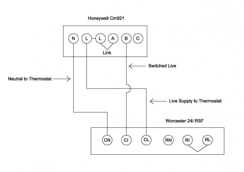

Morning everyone.
I have just purchased the above wireless controller and after looking at the connections was just wondering if my wiring is correct.
On the boiler I have removed the original Mechanical timer and replaced wire link.
Using X2 terminals CN, CI, CL
I have connected
CN - Not conected
CI ----->B
CL------>A
Do I need a wire link between L & A ?
Do i need a wire link between L & L in relay panel ? The reason being that I have placed the live from the boiler into the L terminal directly next to the N terminal, does it need to go into the far L terminal ?
Thank you and hope I can get this working. :)
The Honeywell needs a Neutral supply, which you don't mention (other than not connected). It also needs a Live supply and a Switched Live connection to control the boiler. As the Worcester 24i RSF uses 230v switching, you will also need the link. Here's a drawing. The two L terminals in the programmer relay box are already connected internally.

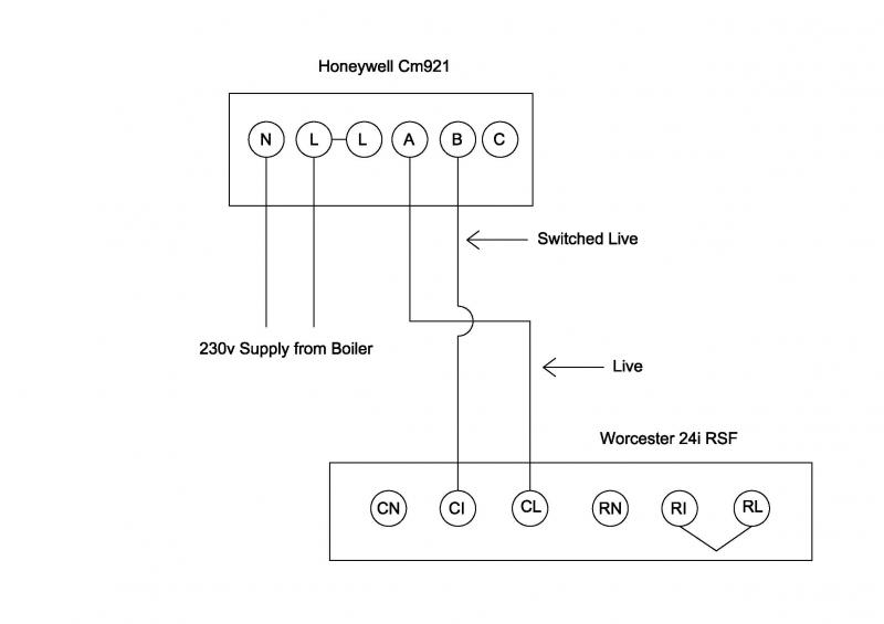

Cheers for that Stem, What I probably forgot to say was that I have the receiver powered directly from the boilers 240V supply terminals L & N and not from treminals CN, CL, would this matter ? APart from that I am only missing the link between L & A
Cheers
Andy
OK. It's not the usual way, as it's normally easier to run one 3 core, than two x 2 core cables.
So as you have a separate N & L supply from the boiler, and have run two separate live wires to 'L' & 'A', you don't need the link, and what you originally stated is OK.
CI ----->B
CL------>A
Cheers Stem, thats what I have as connected. will post back here if any problems
