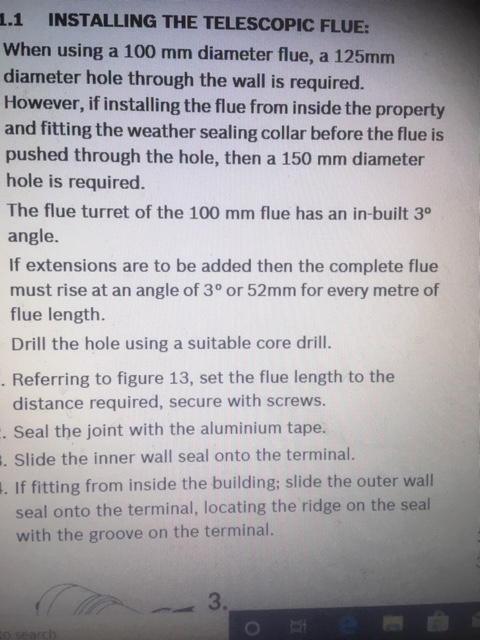

but despite the flue angling upwards 52cm in a metre
is it just a standard horizontal flue without any extensions ? if so that is your problem if it is a standard flue with no extensions the flue is cored level as the internal flue has an inbuilt 3 degree, fall back to the boiler, it cant possibly be 52CM in a Metre can it

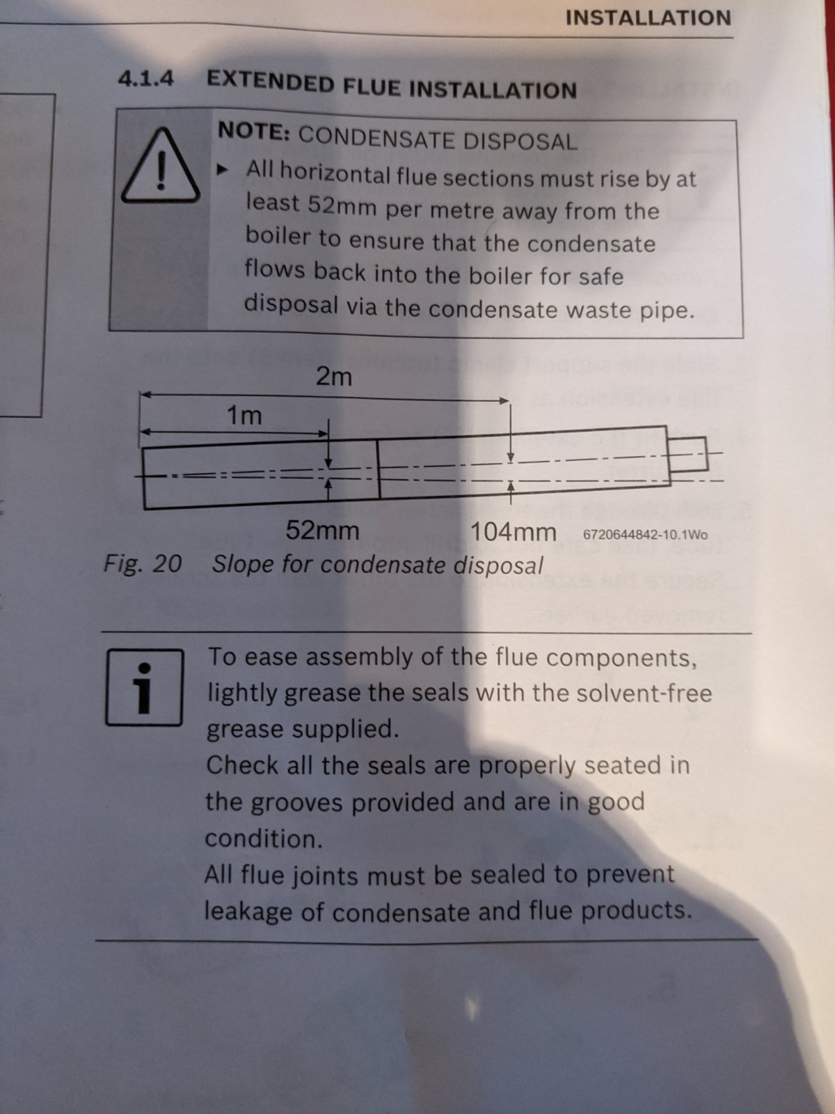

Yeh so this is my Beef, if a pipe is inverted backwards then during an extremely heavy rain shower any water that gets in will run backwards into the boiler...
You have answered your own question with those pics , look at the top of the page on them, that is for EXTENDED flue applications, your is not extended and should be level as the inner flue already has a built in 3 degree fall

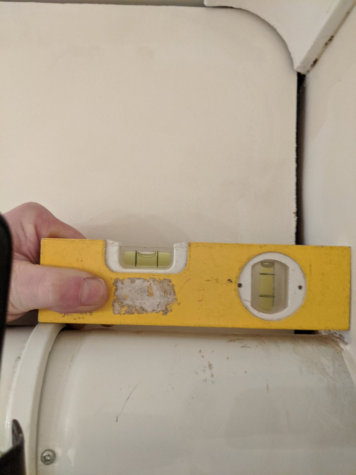

Thanks for the information Ianmcd and for pointing out I was reading the installation incorrectly. It transpires on checking the flue with a boat level that it is actually level if not a couple of mm downwards.
This does take me back to my original argument though, the inner flue gas a 3 degree fall for condense, therefore, in this instance the rain that has found its way in will go into the boiler. Just seems illogical to me and not really a premise to refuse a warranty claim.

I agree and different manus have different conditions, must admit I have never heard of that from Worcester to be honest, they make a big deal of saying that theirs isnt a warantee, but a guarantee, so if the flue is indeed level I would pursue it, out of interest does your condensate pipe run outside into a rain water down pipe ?
