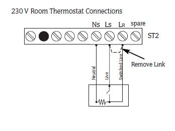

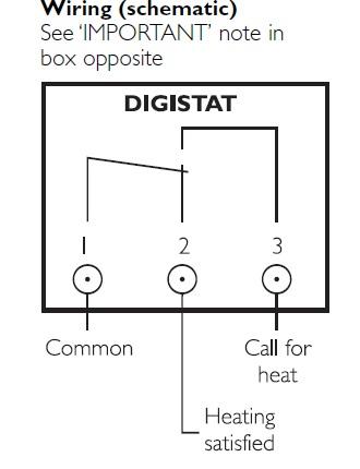

Hi,
Have searched the forum and can't seem to find an answer to my question so I apologies in advance if someone else has covered this. I have a Worcester 28i Junior Boiler and wish to fit a room thermostat. I have a Digistat 1 thermostat from my old boiler that I am hoping to install. I have the instruction for both the boiler and the thermostat but they do not seem to marry up, can someone tell me if the Digistat 1 is compatible with my Worcester 28i?
LS to 1
LR to 3
The stat doesn't need a neutral connection from the boiler as it runs on batteries. Terminal 2 on Digistat not needed for this installation.
