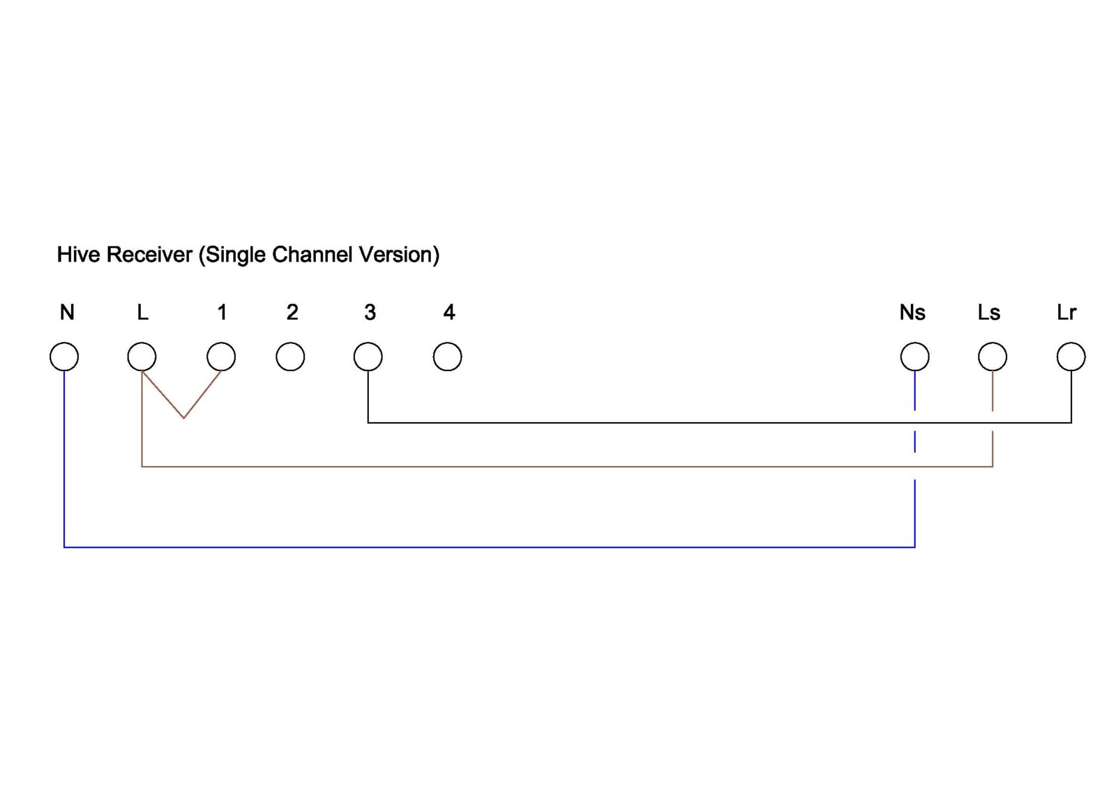

I wonder if anyone can advise, I have the above boiler connected to a hive system, when we switch the heat on via hive the controller says the boiler is heating but the boiler isn’t firing up, thinking it may be the hive system I disconnected the hive wires from the boiler but it still won’t fire up.
The only difference I can see is the built in programmer is still lit up on this boiler, on all my others there inactive, nothing visible on the displays.
So I disconnected the hive and put the heating to on and nothing thankfully the hot water is working, any ideas guys please
Al
Any built in time control on the boiler should be set to be permanently 'on' otherwise it can override the Hive.
When you disconnected the Hive, I assume that you didn't just disconnect the wires, otherwise the heating wiring would be 'open circuit' as if the heating was 'off' so the heating wouldn't operate.
If you have a single channel version of the Hive, put it back exactly as it was, but also add a wire link between Hive terminals 1, (Common) and 3, (Heating on) That will by-pass the Hive and should put the heating permanently 'on'. If the heating works now the problem is with the Hive.

If it used to work, nothing has been disturbed, and the hub is working OK, then it does look that the Hive may be faulty. Before you added the link, had you tried pressing the button on the Hive receiver to see if the boiler worked then?
Hi stem, I found another one of your posts on the same subject and rewired as per your diagram below, and it’s working great now mate, very strange, but thank you for your help today and in the past on this very subject
