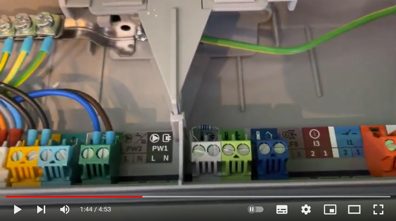

Anyway, there’s a short Youtube video of a gas engineer called Richard, from Mid Wales Plumbing & Heating Supplies (which I think is also the Intergas Shop), converting an 8000 regular to PDHW. The important bit seems to start at 1 min 38 secs. He says he’s fitted a 10k Ohm resistor where the cylinder sensor would go. Then he says something I don’t understand, along the lines of the boiler now thinks it’s 30 degrees. But having done this, he says PDHW is enabled, and can be controlled by any external controller.
He is using EvoHome, but he says any controller can be used. My uncle has an S-Plan with a normal cylinder thermostat. I’d like to know if this might be possible with my uncle’s set up. Here's a still from the video showing the resistor.

The resistor is just to fool the boiler into thinking that it has a WB cylinder sensor installed & that's reading 30deg and then using some clever wiring with a separate switching relay to switch the external controls over from CH to PDHW plus the OT system set to run as PDHW.

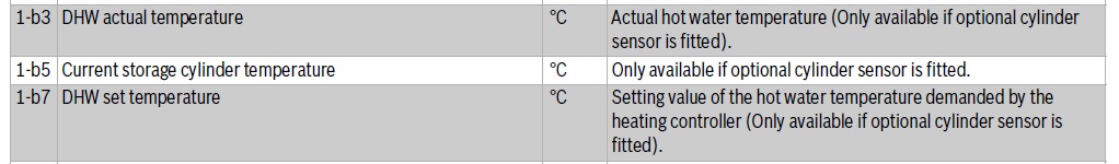

One said this boiler can't do PDHW, as it can only provide flow at one temperature. The other one said that the settings below have been printed by mistake in the manual, and should only be in the system boiler manual. It's all a bit bizarre, because we have seen above that the cylinder sensor connection is present and active in this boiler, and that two different flow temperatures can be produced. I'd have thought this would be something they would want to promote.
