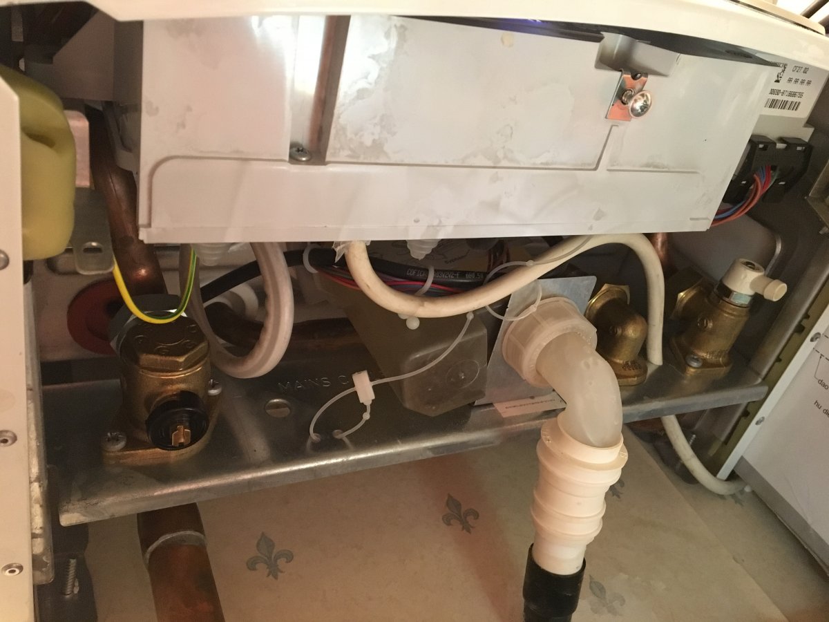

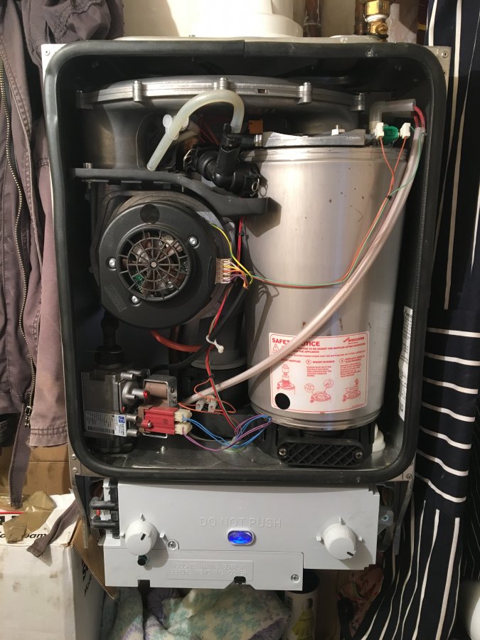

hi all, happy new year. Wondering if any one could help with a Worcester green star 15ri I've recently moved into the house and bled the radiators as they were cold at the top but can't find anywhere to top the water pressure up or find out if the pressure is low, I presume it is low as some of the radiators when central heating has been on for an hour are still very cold and some are baking hot? I've taken the cover off to find nothing that's like my old baxi combo boiler Any ideas are appreciated thanks all

is there a fill up line like the one below in the pipework below your boiler?
Hi, it just has what looks like a drain pipe under the boiler

Is there a small tank in the loft ? It could be tank fed.
Its an Ri so unlikely to be pressurised which is why you cant find a filling loop or guage. Chances are theres a header tank in the loft feeding the heating system.
If system is unbalalanced try the FAQs section on balancing radiators.
P.S. Pop the case back on before the gas police turn up here.

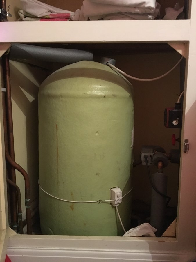

There is an emmersion heater upstairs would that have a plastic square tank or would that use the same tank as the boiler?
There should be approx 4" of water in the tank in the loft, when you bleed the rads it will automatically top up the system for you (as long as there's no blockages). When you say immersion do you mean its there in a cylinder or just switch somewhere ?
This is the tank in the bedroom then there's a square tank in the loft, when we moved in we were told there's an immersion water heater incase boiler fails but it's expensive to run, so presumed this was it?
Thanks for all your help I've balanced the radiators and it's a lot warmer all over the house now+ found out about immersion heaters ( I thought it had its own tank
