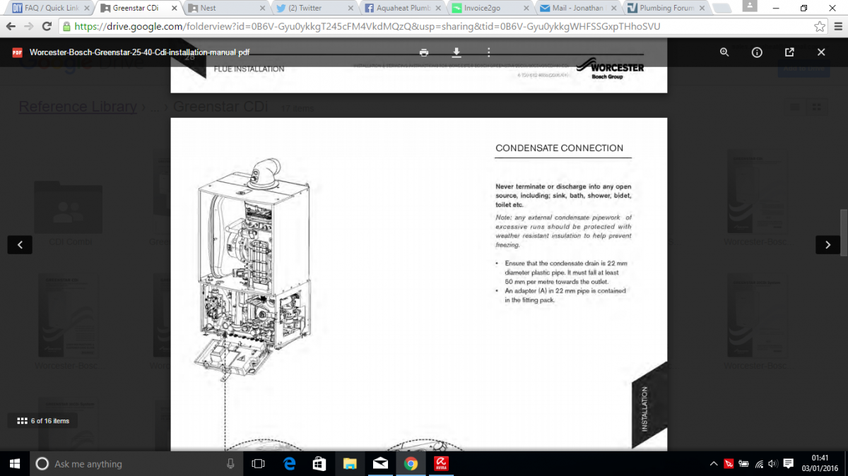

Hi Guys,
Need some advice with a blockage in my condensing pipe for my Worcester 30CDi boiler. The boiler is around 5-6 years old and has been never serviced(my fault). 2 weeks back the EA error kept flashing and the gas engineer opened few pipes and I could see lot of junk most likely a compound of Aluminium. He told me that as the boiler was not serviced the junk entered the condensing pipe and blocked it. Now I am running the boiler with the condensing pipe in a bucket.
My question is is there a easy way to melt/clean the Aluminium junk in the plastic pipe, if I m not able to do it then I need to replace the condensing pipe for which I need to remove my laminate flooring.
Any advice will be appreciated.

@simond From the 30CDi MI's note the never terminate into an open source.
Jon
Yes, I think that the above is undoubtedly the right advice from Worcester Bosch - if the OP was installing a new boiler. But his is already installed, not working, due to the condense pipe being blocked.
The OP said he was running his condense pipe into a bucket. The only way you could connect a pipe to the Worcester 30CDi is via the internal trap, so ergo it must be in place.
