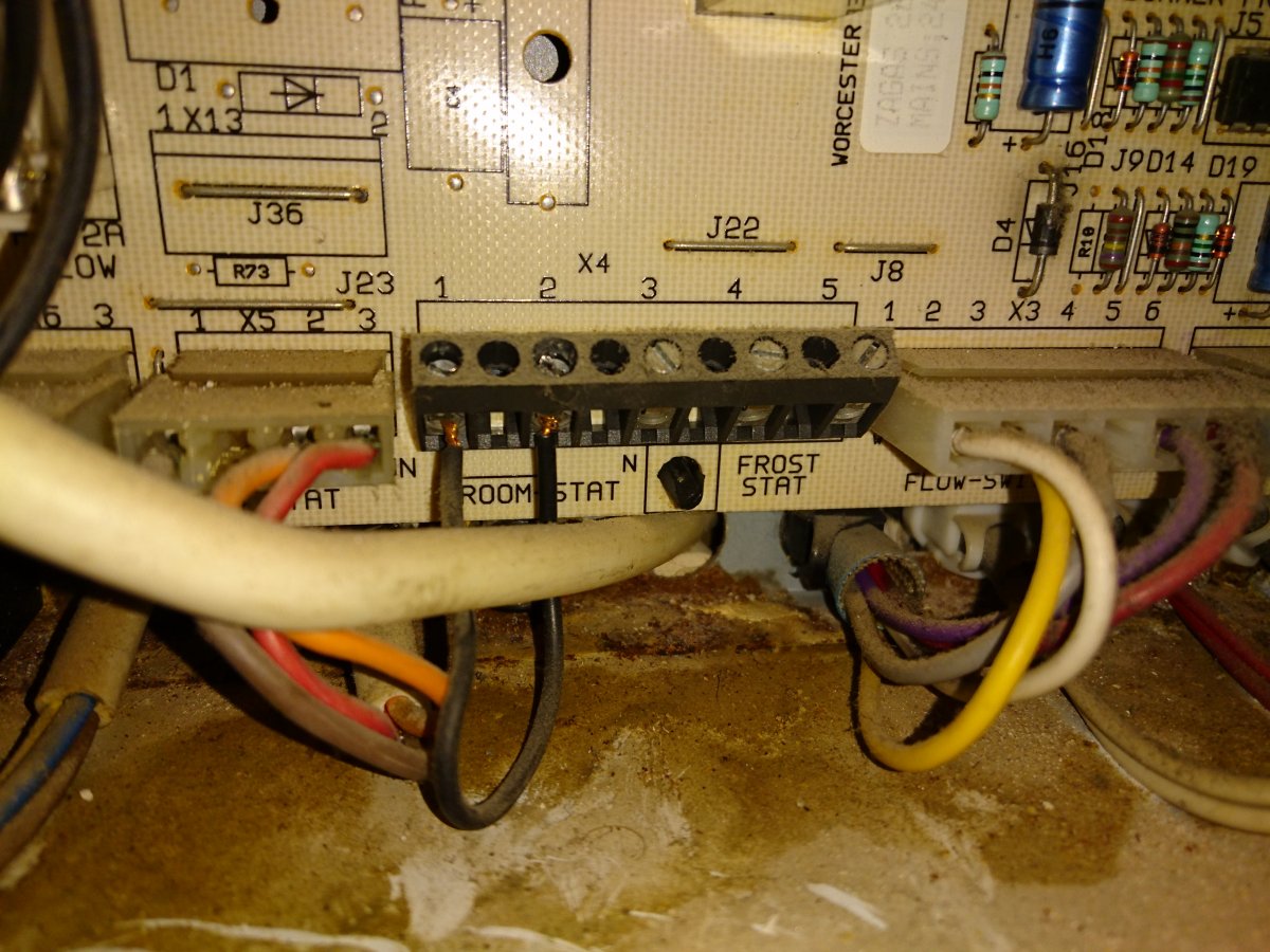

I've looked at the wiring diagram for the 240 and checked the board and can see that there is a part of the control board for a room stat to be wired in which currently has a small loop of wire connecting 2 pins.

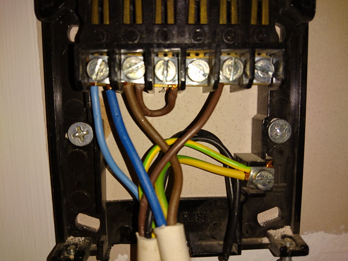

Single channel Hive connects to your room stat connections and permanent live / neutral. Not too sure how you've wired it in
Hi,
It is wired in exactly the same as the UT2 was previously as the backplate is compatible. Literally unclipped the UT2 and clipped on the Hive.
Thinking about it now it would appear that the UT2 was literally turning the mains on and off to control the CH coming on and off which is going to stop the boiler firing for water if it isn't giving power. The Hive will be replicating this.
Should it have been wired like that as surely dropping the power off when turning the heating off will stop any pumps running whilst heat is dissipated at the end of a cycle etc?
I've attached pics of the backplate and the cable coming into the boiler.

I would be hooking it to the the boiler in place of the loop at 1 and 2 on roomstat termination in your picture

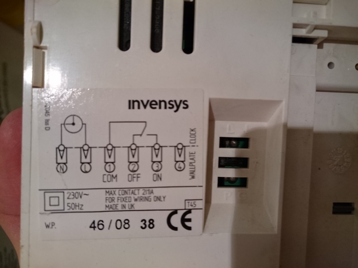

So how would that correspond to the backplate as per the Hive diagram and the links on the boiler?
hive-png.86549
Permanent Live, neutral and Earth wired across to their current locations on the main board then Heating on (NO) to the 1 at the room stat location having removed the loop? Would I also run the Heating off (NC) to point 2 on room stat at the board?
So if that is correct I would leave the main boiler switch on Heat and Water so that water is available and then the Hive would turn the CH on and off as required?
You use C and NO contacts for where the loop is
Thanks guys. Working as it should now. Just needed the one wire from 3 on backplate to 2 are x4 on the boiler. Happy days.
Where does C of backplate go?
Remember, condition at 1 of X4 goes to 2 of same block with that wire link
The link is removed with that action taken over by 1 and 2 of the back plate
Your boiler may well be working but it is not the voltage at 1 of X4 that operates the boiler but voltage from elsewhere (L terminal of backplate?).
Looked at the schematic and your backplate. I hope you have correct fuses in place as you have bypassed the 2 amp fuse that protects the pcb during CH demand:)
