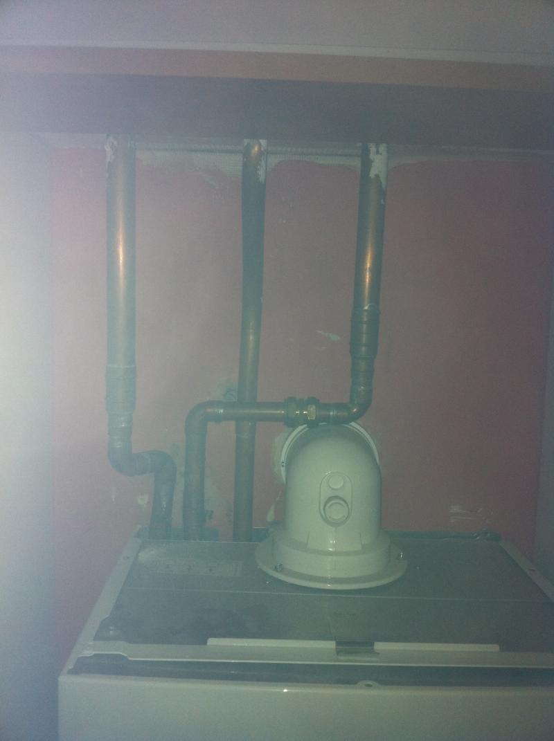

22mm pipe off the top of the boiler , 3 port valve and boiler still set on full output ?

there are two pipes coming off the top of the boiler, can you tell what size they are ?
The two on the left hand side are both 90mm copper pipes. Are they the ones you mean? Sorry to be vague
