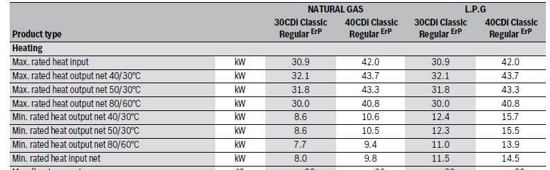

Your boiler will already modulate its power output automatically between about 8kW and 30KW. But I think you might be talking about using a modulating thermostat. I honestly don't know whether it can. On their regular boilers Worcester Bosch seem to restrict some of the more interesting functions. I don't even know if it can do weather compensation.
Yes, it's a modulating boiler, albeit not a very good one at just over 4:1. It doesn't support OpenTherm, Worcester want you to use your own modulating controls, although even then you can do very little with the Regular boiler.

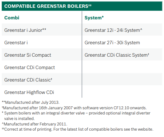

Potentially EasyControl is compatible with this boiler but depends on the manufacture year - https://www.worcester-bosch.co.uk/downloads/bosch-easycontrol-brochure.pdf. However, I've yet to see if I want to invest in a smart system from themselves and forever be tied to one manufacture.
Do you mean the following table. A system boiler is different to a regular boiler.
Yes that is the table. I appreciate they are different but from the table, both the Greenstar CDi Classic and Classic System are compatible. But I now see that "Classic Regular Erp" is not listed.
