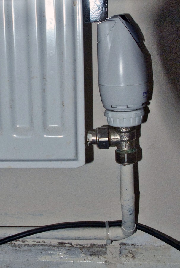

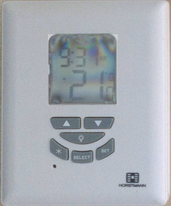

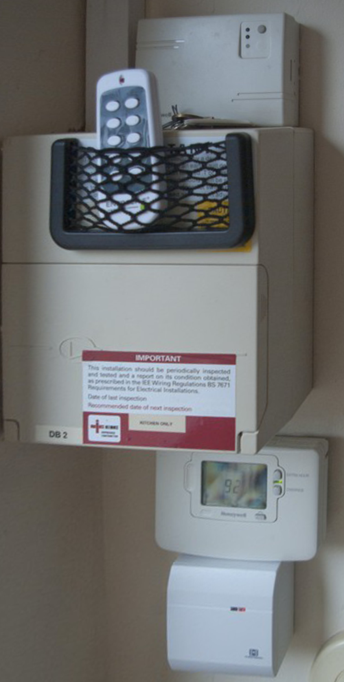

I put the two base units 1671029110228.png with some distance between them so they did not interfere with each other, honeywell at top, Horstmann at bottom, but once the TRV heads were programmed IMGP8041.jpg not really sure what the wall thermostats did, as in Winter boiler would turn on at 7 am and off at 10 am and the TRV's controlled the radiator temperature to maintain each room, and the boiler also a Worcester Bosch modulated to suit, Spring and Autumn the wall thermostats may have turned off boiler, but in heart of winter wall thermostats did nothing.
