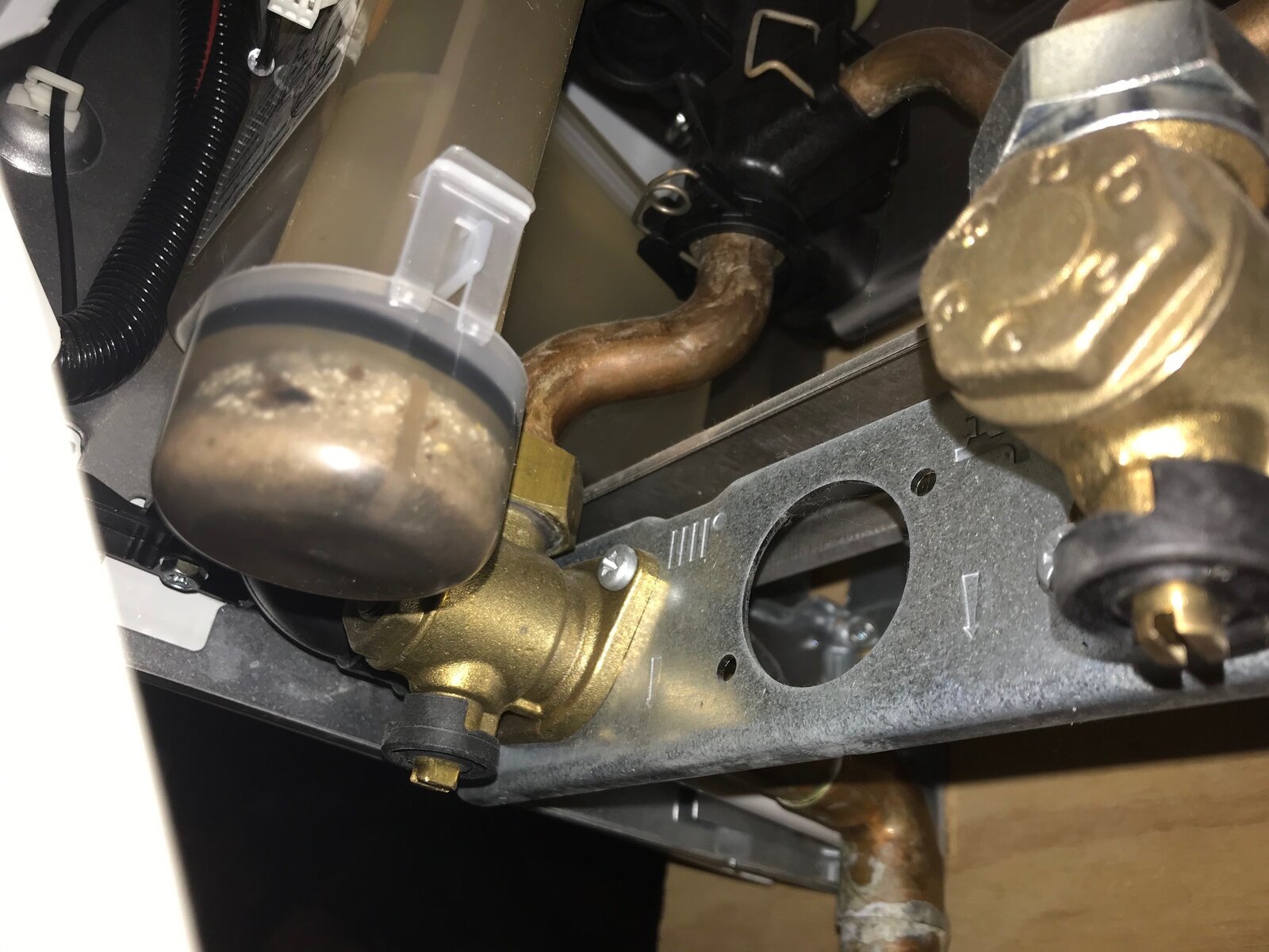

Evening all,
Condensate trap on the boiler is full of crap (as per photo) and we are getting EA messages related to the condensate exiting - probably due to freezing but this could also be causing an issue.
Manual is fairly unclear on whether boiler will refill the trap automatically as part of a program, or I need to manually fill the trap before turning back on.
We are self isolating - hence can't get a plumber over.
Thanks in advance
It does have a trap filling program, which will kick in if you turn the boiler off for a few minutes then turn it back on again. Be careful emptying that, there's quite a bit of water there and if you get it wrong it can get into the PCB. EA is most likely a frozen condensate, there's not so much dirt in that trap that it would completely block the flow
Thank you - I’ve disconnected the rubber gator which fits over the pipe and diverted that into a bucket for the condensate whilst we have this freezing weather which seems to have sorted things.
I’ll leave the draining of the trap to a professional at the next opportunity!
