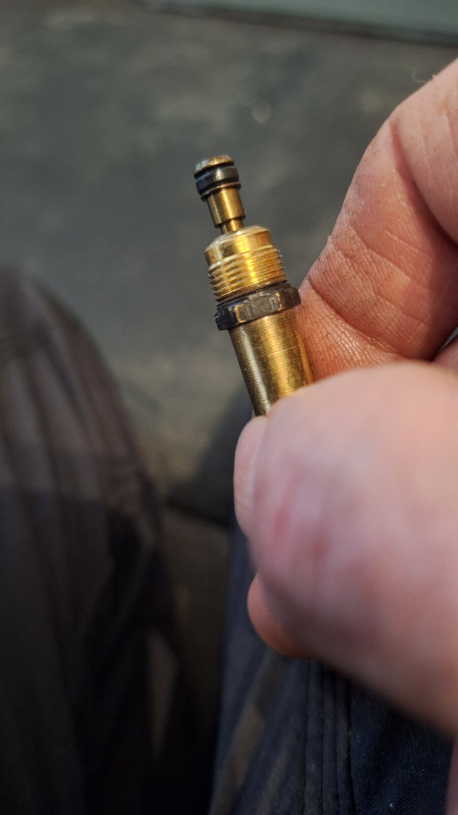

Hi all , I'm hoping that someone could shed some light on a frustrating problem I have with the oil pump on a Worcester bosch heatslave 12/14 , it seems there some reason that on initial fire up from lockout, the start up sequence dose not operate in the correct order ?,
If I'm right believing that the sequence should be
Fan motor
Spark
Ignition
Photo cell
Selanoid
But my sequence is
fan motor
Fire up
Lockout
No click from selanoid
I've checked everything and replaced nozzle , bled the air from the pump with gauge and set pressure at 100 psi , stripped the pump completely, fitted new seal kit to the pump the only way I can get the burner to fire up and keep running is
Turn oil pressure way down to 20 psi until the selanoid clicks then wack the pressure back up a good half of turn and the burner runs sweet
If anybody has any suggestions I'd love some advice please, I'm at a loss with it now

If the burner fires before the control box initiates the solenoid then it will lock out as a false flame. It would appear that the solenoid valve is passing as when you turn pressure right down it operates correctly. Clean out the solenoid port and if it still fails, replace the pump.
I think I have found the problem and it was also backed up by Worcester bosch service technician who I called this morning, I had a suspicion that it could be the mechanical che k valve located in the Nozzle assembly tube , I explained my problem to him and I also suggested that the check valve may be the problem , because there shouldn't be oil in the nozzle while the fan first starts running and not before the selanoid opens the oil supply , because there's oil in the nozzle tube it fires up straight away then the photo cell sees it and puts it into lockout , this is why if I turn the oil pressure right down before the selanoid click the burner doesn't fire, but once it clicks and I wack the oil pressure if it fires and works as it should
So I've ordered a check valve as they don't have any in stock in Cornwall, it will be here tomorrow morning , will keep you posted
Many thanks for your and burnerman help and suggestions it is much appreciated
Finally got to the bottom of the problem , turns out it's the small Oring seal on the bottom of the Selanoid plunger all sorted now back up and running , thanks again both of you (Burnerman & Oilhead) for your help muchly appreciated
