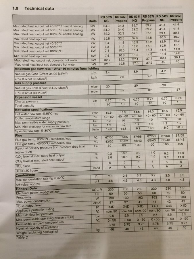

Can anyone tell me which figure on the attached for my British Gas (WB) RD537i is the central heating output normally used in comparisons? I think it is 37.1KW @ net 80/60 deg.

It is a combi boiler and so the power is related to water heating and not central heating. You have been accustomed to 37 kW and so I would not recommend anything less than a 32 kW boiler.
Your gas registered installer will suggest suitable alternatives.
Worcester were very slow to start selling plume management kits which surprised me.
Unfortunately we are only allowed to use the manufacturer's flue components sold for the specific boiler.
I expect there may well be other flues with the kits which would fit but we are not permitted to use them!
Tony
As Tony has suggested, it's highly unlikely that your home needs 37kW of heat. I'd be surprised if it needs even half that. My 4-bedroom 1970s house uses 14kW. To size your replacement boiler, you need to know what your incoming mains flow rate is in litres per minute. You can find this out by timing how long it takes for a bucket of known capacity to be filled by your cold bath tap.

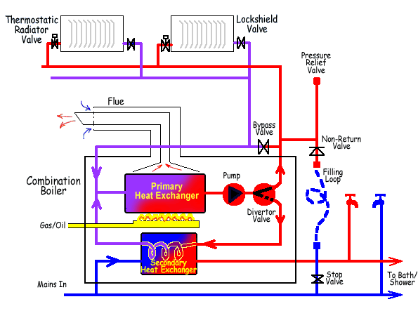

I don't really understand how Combi's work
This diagram may help (not all combi boiler work in exactly the same way, but the principal is the same).
When hot water is not required, the heated boiler water is pumped through the radiators.
When a hot tap is turned cold water from the mains starts flowing through the secondary heat exchanger.
A flow detector operates the diverter valve so the hot boiler water produced by the primary exchanger passes through the secondary exchanger.
The cold water is therefore heated up.
Because the cold water is travelling relatively fast a considerable amount of heat is required, depending on the flow rate.
For example:
Flow rate 10 litres/minute; temperature rise 35C (say 5C to 40C) will require a heat input of approx 25kW (a rise to 60C would need 38kW).
The central heating requirement is normally much lower -as others have said. You can find out how much your house needs by using Baxi Whole House Boiler Size Calculator.
