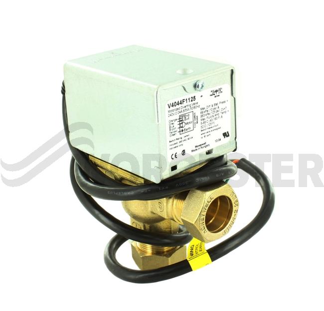

Terry, it is the V4044 type.
At the moment, the actuator motor and the diverter valve are free to turn. I've replaced the actuator motor on numerous occasions, it's the most common fault I've had over the years. I'm suspicious of what's going on inside the valve though, as I can't understand why hot water is getting pumped to the radiators when we turn on a hot tap? I don't know what the valve internals consist of i.e. metal/plastic/rubber etc?

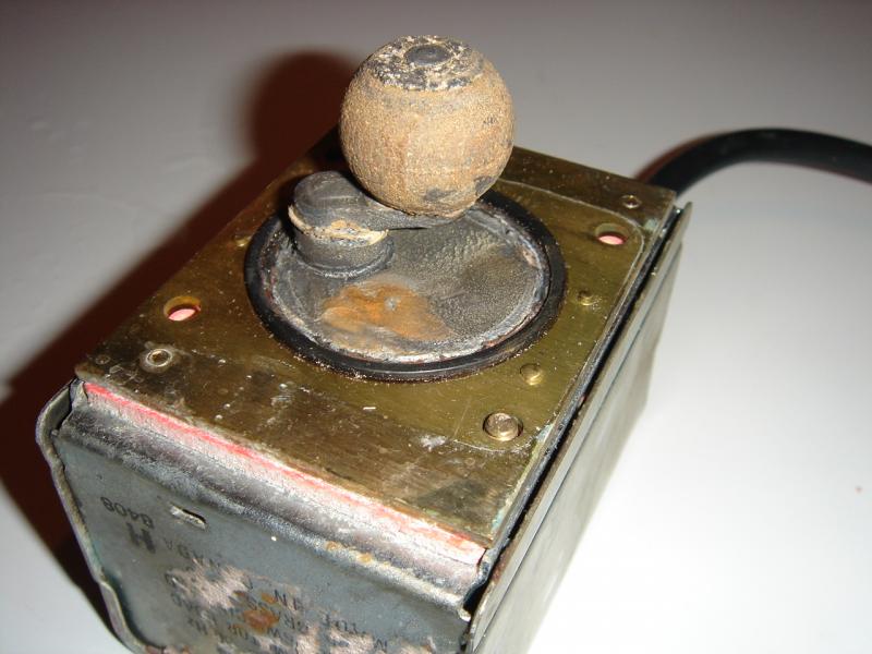

It's a rubber ball that sometimes detaches itself.
I see. This is actually starting to sound more like it could be the problem.
I have also noticed that that water pump is scorching hot when the central heating is on and no heat is coming to radiators. Could it be that the pump is trying to pump against a closed valve, so it is just overheating as it can't pump? Then when a tap is turned on, the valve is open and the heat goes out to the radiators. It's like the ball is 90 degrees out?
Extremely rare for the ball to fall off...seen a few times in 20 years.
If the seats are ok a replacement ball & plate kit is cheap.
Cheap motors can magnetise in the open position and the springs can fail to return the mechanism.
Mmmm, that's not what I thought it looked like. Obviously I've found the wrong type :unsure:. Looking it again, it may be the VC type of internals I found. It was a cartridge assembly.
Are you sure you don't have a convention Honeywell V40... valve?
The picture shows an old style actuator with the ball & plate...missing the valve body.
The VC type actuators can't be pulled apart and the motor is not accessible.
The motor is accessible on mine, as I've changed it many times. By "looking at it again" I meant looking at what I'd found on the internet for the internals. I think I found VC internals.
Mine looks like this.....
