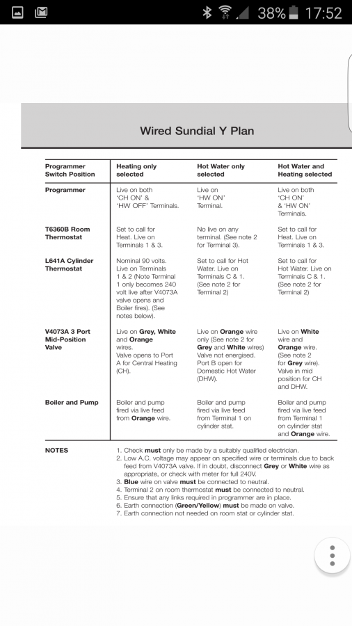

Yeah I have one. Unfortunately its not so easy to probe behind the tempus but there is a junction box in the airing cupboard where it all goes to (cables are a mess)
When the problem next happens you need to get your multimeter out. Make sure hot water is not calling for heat. Check the white and orange wires from the valve. If the white wire is live then it is a problem with the thermostat. If the white wire is not live and the orange wire is live. Then it's the valve
