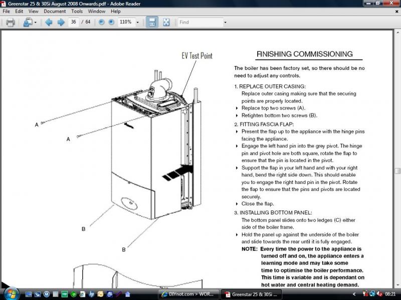

The ammount the pressure rises by during expansion will depend on the water content of the system, the 30Si only has a 6 litre expansion vessel which is good for about 9 to 10KW of heating load. To check if it needs re-pressurised you will need to drop the system pressure to zero and test with a tyre pressure guage. The test point (black cap on a red EV) is behind the boiler at the top IIRC it should be 0.75bar.
Depending on the size of your system you may need an additional EV.
The PRV should not be letting by until 3 bar though. It may be faulty or the pressure guage may be faulty (have seen a few on the Si's).
And get your installer back to terminate the prv cos if it blows you (or anyone in the vicinity) could be scalded.
Hi there again & thanks for your replies as always.
I found the test point re the EV. It was a little difficult testing the pressure exactly, due to the lack of accuracy on my pressure gauge. Nevertheless, I think I had it at about .75 Bar & it has made no difference.
