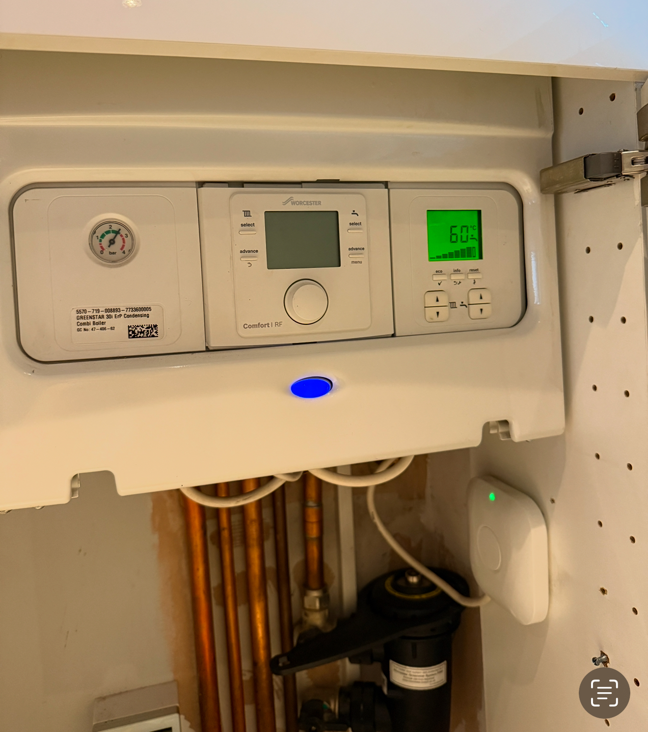

Hi all,
We’ve just had a new Mira Plarinum Dual Digital shower installed in the loft, feeding down to the bathroom upstairs which is great.
However, it has an error saying that the incoming hot water temperature is too low.
I’ve checked our Boiler (Worcester Greenstar 30i) and its set at 60 and other tap outlets do get really hot. The boiler isn’t too far away from the shower really so struggling to work out why it’s not reaching anything above 35 degrees to the shower incoming outlet!
First question is, I could try increasing the water temp to 65 but my boiler won’t let me set it past 60! Unless I’m going mad. Here is the pic:
Secondly, apart from putting some lagging around the small amount of exposed copper pipe in the loft to keep it warm, is there anything else I could try?!
It’s a really expensive shower that is potentially wasted now because it’s not getting the hot water temp it needs. Nightmare!
I have a Next thermostat controlling radiators but I don’t think it has Heatlink so don’t think I can control hot water temp from this.

Have you measured the temperature of the hot water ,at the shower and taps ?
I highly doubt you would get the temperature loss that you suspect if the boiler is putting it out at 60⁰C.
The pressure gauge for heating system is showing a little on the high side ,do you have a large number of radiators ? If it gets to the red section on the gauge the PRV will operate and dump water out the system.

Just regarding the pressure gauge, this was actually much lower but one article said to fill more to see if that works but probably filled a bit much!
I mean, what else could be physically causing this temperature loss you think? The taps get proper hot.
