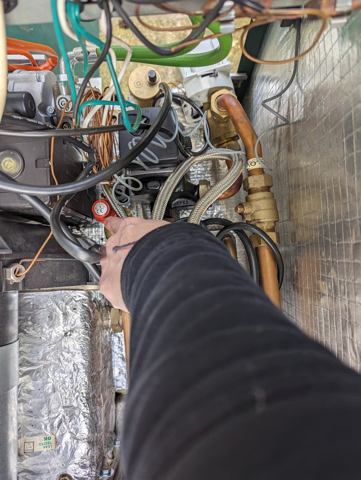

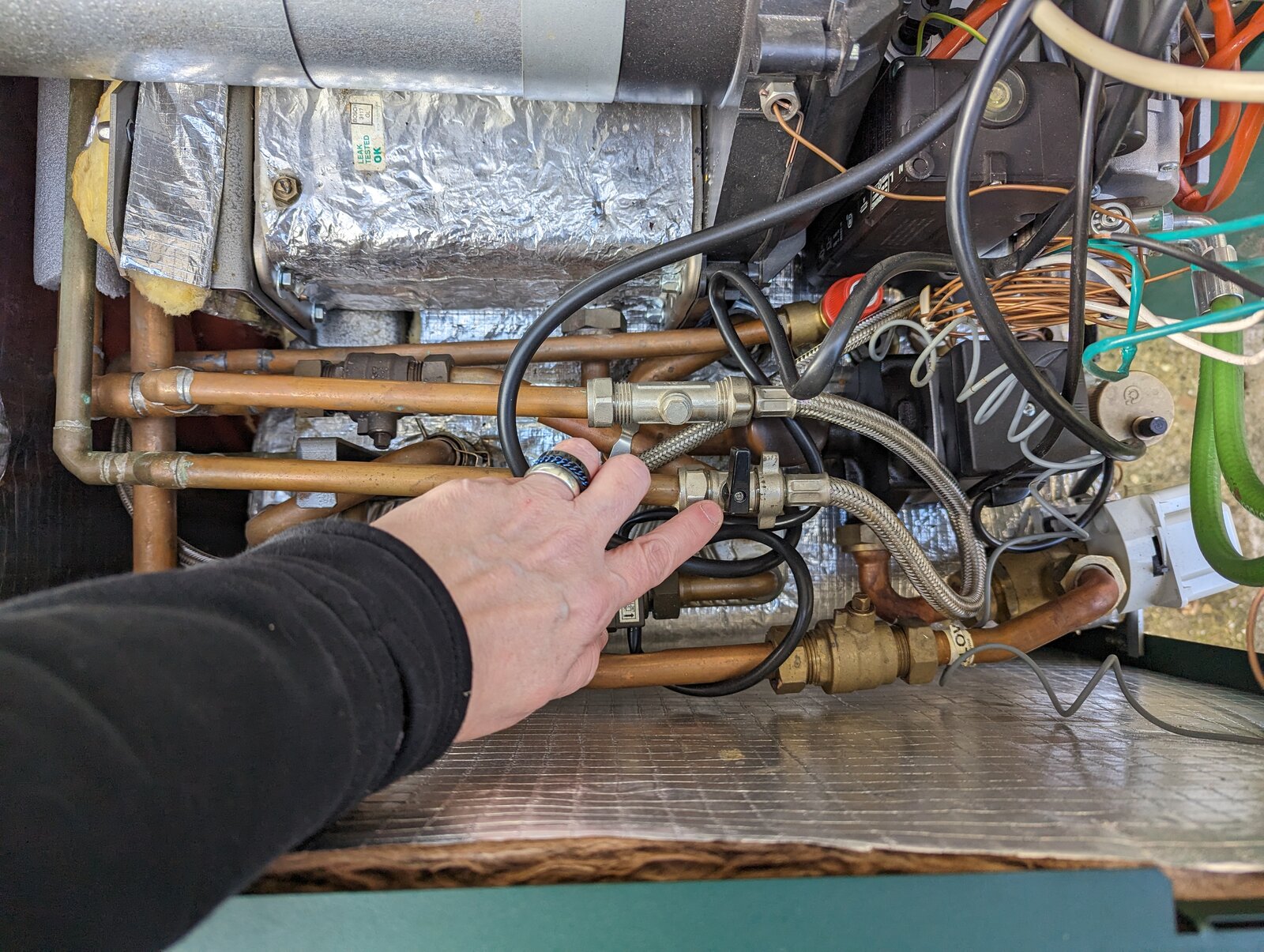

I have a couple of pictures of the inside (taken from the top of the boiler)
I've turned the black valve (photo below) - I can hear water travelling at pressure and the pressure gauge on the Worcester boiler goes up to 1 bar from almost 0.
On the other end of the hose is a "nut" I've not touched it as I don't know for sure what it is (pointing at below)
Picture below I can see "something" mentioning psi which a wire from the boiler pressure gauge goes to.
If your getting pressure up to 1 bar that's fine.
Ignore nut your pointing to, drain point that never gets used.
The red cap thing is pressure relief valve with pressure gauge connection.
