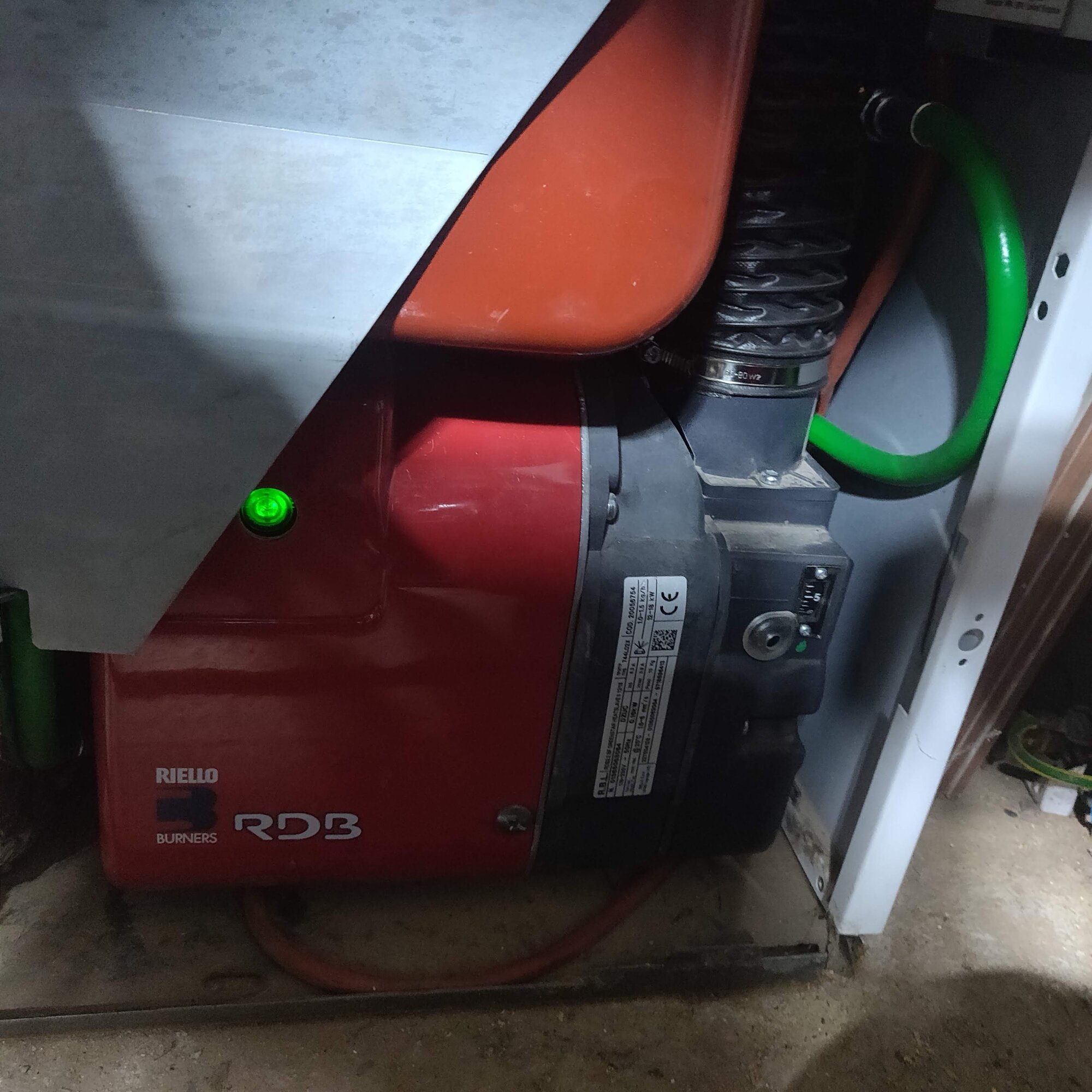

Thanks Everyone... I took the front off. Sounds like its coming from this motor (the burner?)
I had it serviced a couple of weeks ago, the green tube is new, after I was recommended I 'upgrade' from what was there.
Yep, that’s your Riello burner - the green pipe is a long life oil feed which has a significantly longer safe running life than the original braided one.
John :)
