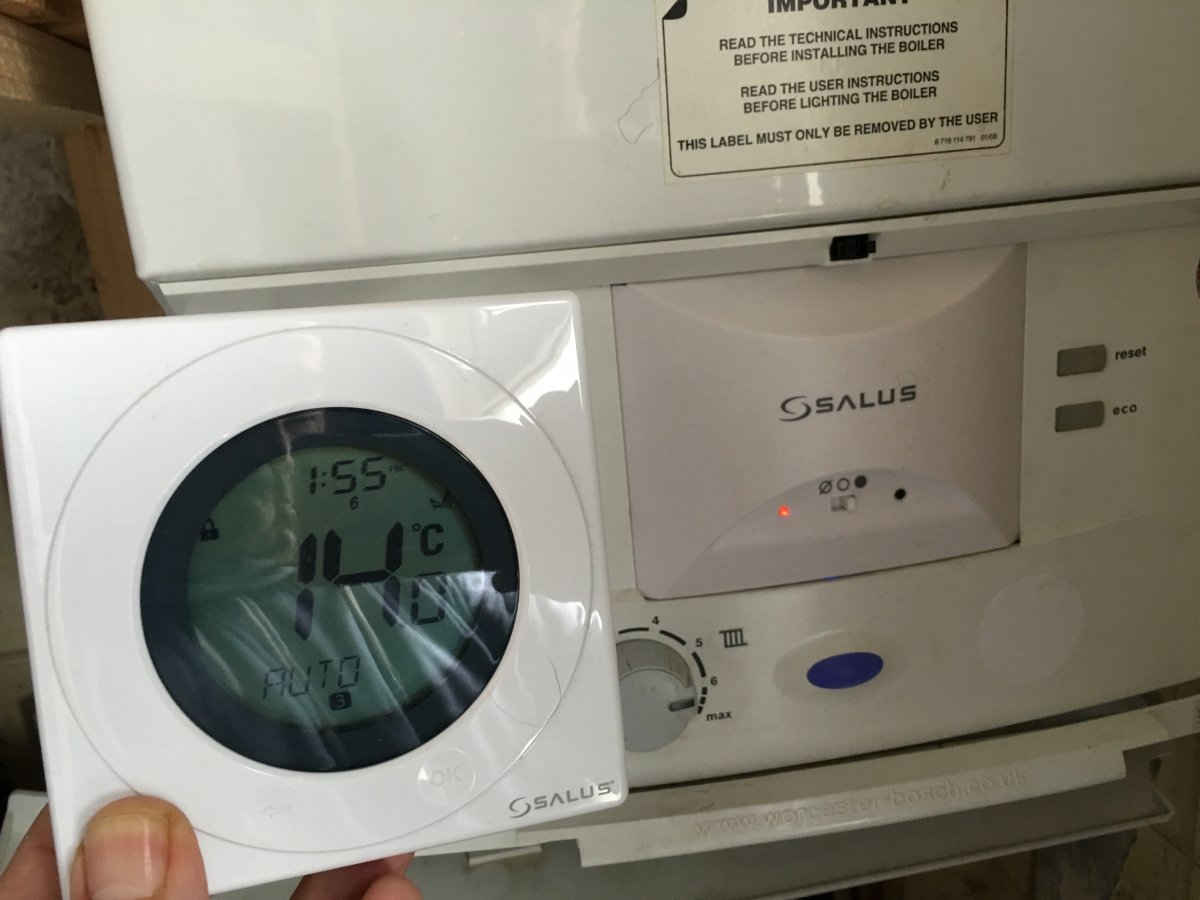

Worcester Junior 24i - Mechanical (MT10) clock not working, no heating even on over-ride kept time OK but when overiding no heat from boiler. I replaced Mechanical clock with digital Salus ST620WBC version (wireless). Receiver comes on (Red transmit/receive light on) but heating still does not come on. Hot water fine. Just had an engineer in who says I need to contact Worcester Bosch to get a replacement PCB. I was expecting him back with the part today but he has just rung back to say I need to contact Worcester Bosch to get the part myself. I have now spent £170 for a half job. The Old receiver allowed me to get heating whilst still connected (I assume it paired up with the new Salus transmitter/control console) but since I have disconnected that the new receiver does not seem to connect to communicate with the boiler.
Anybody know if I should be looking at other things before I replace the PCB? If I hold the maintenance button down for 5 seconds the heating does come on briefly.

Hot water runs fine, it's my heating that is the problem. I should be able to program times that my heating comes on using the wireless console/controller OR over-ride the programs to have constant heat. (Either wirelessly, using the console/controller OR directly by flipping the switch on the wireless receiver from "auto" to "manual"). There seems to be communication between the console/controller and the wireless receiver as the red light on the receiver lights up whenever I make a change on the console. The "instruction" just does not seem to go any further ie: the Wireless receiver is not communicating with the boiler (either wirelessly or manually, when the switch is flipped from "auto" to "manual").

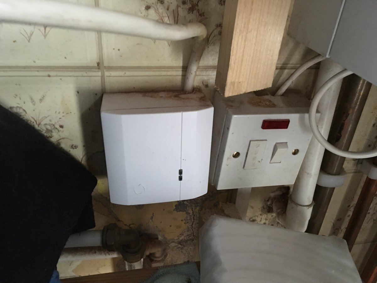

Hi Johnmdc, NO, I have replaced it with a Salus Wireless ST620WBC receiver and remote console/controller. I did have the old wireless receiver (wired in) and my NEW Salus remote console/controller somehow did pair up with it and I could manage heating OK from the remote console/controller BUT I could not manually over-ride by flipping switch, on NEW receiver(replaced in space where OLD mechanical MT10 was attached) from "auto" to "manual". I could not manually over-ride with the OLD MT10 mechanical clock but I could by using the OLD wireless remote console/controller with the OLD wireless receiver. (I have uploaded a couple of photo's. One shows the NEW remote console/controller and the other shows the OLD wireless receiver (disconnected) and spur switch). Hope this clarifies things, thanks for your reply!

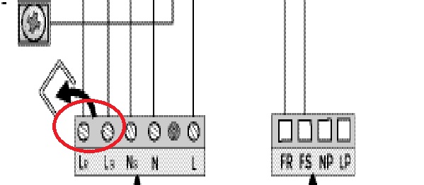

I didn't realise that it was a receiver built into the boiler. When you disconnected the old wired up receiver did you put a link back in between LS and LR on the boiler terminals? If not then you need to.

Thanks again for your reply, I'll give that a try......do I just need to get a short electrical cable to do that, or do I need a special connector? Thanks!

I think we installed in 2009, the current PCB has the right connection and as you can see in the photo at the top of this thread it does power up/communicate. I will however run this by Worcester Bosch Support before ordering the part. Thanks for your reply!
Yes that's it. Just a short piece of wire. Obviously make sure the power is turned off first.
Johnmdc - Thank you so much, that worked a treat, heating is back on & responding correctly to remote transmitter & is over-riding correctly, all is well!
