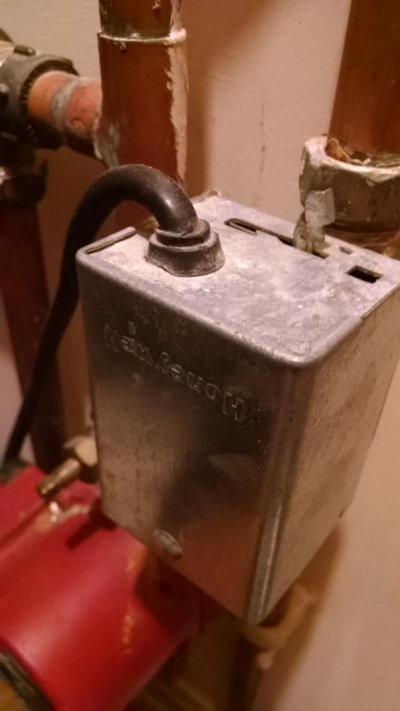

I have a Worcester Greenstar Ri Boiler with an unvented cylinder(Megaflo)
The boiler seems to heat up water without a problem. It reaches a point when it stops burning gas and the indicator light switches off, which I think it is normal. To me it means that all the water in the cylinder has reached an ideal temperature.
The problem is that after about three minutes when this happens, the boiler fires again, burns some gas for about 30 seconds (the indicator light on). Then after this, the indicator light switches off and it stops burning gas. After 3 more minutes it repeats the same process ( boiler fires and burn some gas for 30 seconds, then switches off and fires 3 minutes after). It does this indefinitely. No one in the house is using hot water, there are no leaks and the central heating is not on.

Probably getting 240 v coming back from one of the valves as I'm guessing it's configured with 2 x 2 port motorised valves, if so just need to replace the faulty head. If you have a 3 way valve and a 2 way you may find that the 3 port is back feeding about 70v back to the boiler which will bring it on, the fix for that is a surpressor from Worcester.

I can see two valves as the one in the picture attached. I think one is for the central heating bit and the other one for the cylinder.
I guess that then the fix would be replacing the faulty head?
