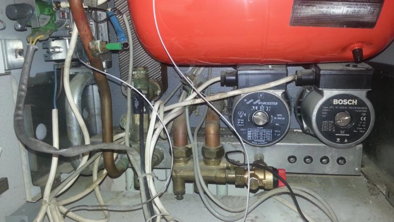

I have added a picture of my boiler is it the green connector on the pipe to the to mid left?
Never worked on this model but believe the black object in the picture below the expansion vessel is your dhw flows witch. Have you checked you don't have any dripping hw taps.

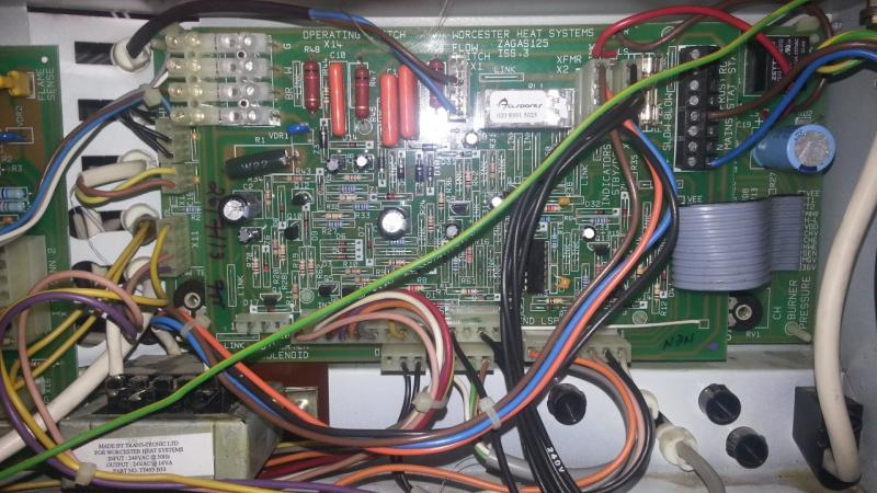

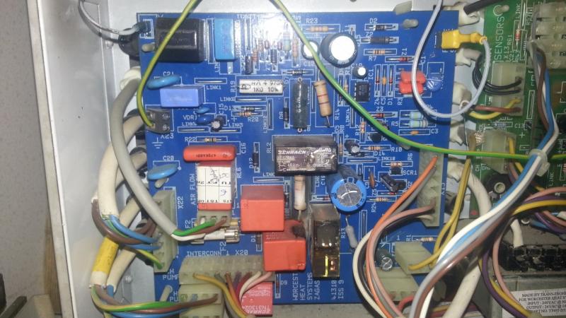

Hi thanks for your replies, I have spent all day trying to suss out what I have done wrong but I don't think I have, so I have uploaded before and after photos (luckily I always take photos before fore I start something like this) just incase someone can see my glaring mistake.
Before
After
Before
After
