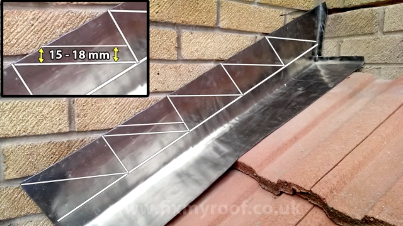

I need to do some stepped Lead flashing over a porch onto double roman tiles so planned to use 300mm Lead.

I watched a video on YouTube and this is what I intend to do:
300 may not get you 150 up the wall, the extra for the joints and the cover for across the tiles - which will depend on the profile.
That image is not correct, as the lead should always go into the trough of a profiled tile. It may work, but it's not right and should not be used as a reference.
But yes, flattened lead could be used, but it depends what it is like when it is unflattened. Always cut with a Stanley whenever possible.

So if I measure from the wall to the far side of the first tile ‘hump’ then add 170mm for going up the wall?
I’ll unroll the sheet and see what’s it’s like.
As long as you have enough horizontal travel to pass up and over and back down a complete profile then you are in good shape. 150mm vertically is plenty.
