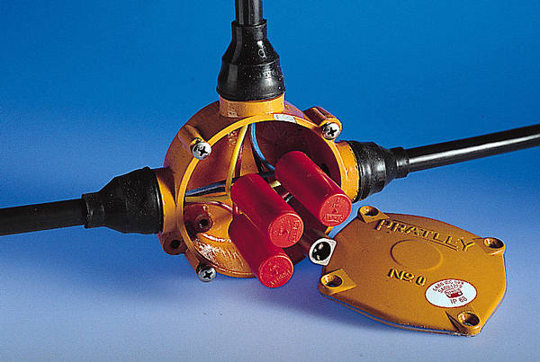

I have the job of providing power to a patio a shed and a garge and i shall be working with SWA cable (4mm) The cable needs to be T'd off in 2 places and I've decided to use resin joint kits.
Anyone used resin jointkits before? How the hell to I use them! :rolleyes: :oops:
Me neither, but I'm sure they come with instructions, and from photos they look very obvious in how they work.
And very permanent and one-chance only, and probably messy.
Thought about using these?
(http://www.tlc-direct.co.uk/Main_Index/Cable_Accessories_Index/Cable_Joints_1/index.html)
They look as though they require more familar skills, and in small sizes are cheaper than resin filled.
All the resin joints I've done (BICC, 3M, Henley etc) have all come with comprehensive instructions. It's not rocket science as long as you make good connections and they are well laid out. You will need a ratchet crimp tool for a start (the DIY compression ones from Halfords are not sufficient!). I always use amalgamating tape instead/or in addition to insulation tape and you should remember to always stagger the crimp joints. This is so that in the event of a problem they can never touch each other whatever happens. The kits for small cables (up to 16mm really) often come too large at the ends. In this case just wrap lots of amalgamating tape around the cables until the case fits snugly around it. Don't start mixing the two part resin until you are ready to pour it in and wash it off your hands quick if you manage to get it on them (it's hard to get off later).
