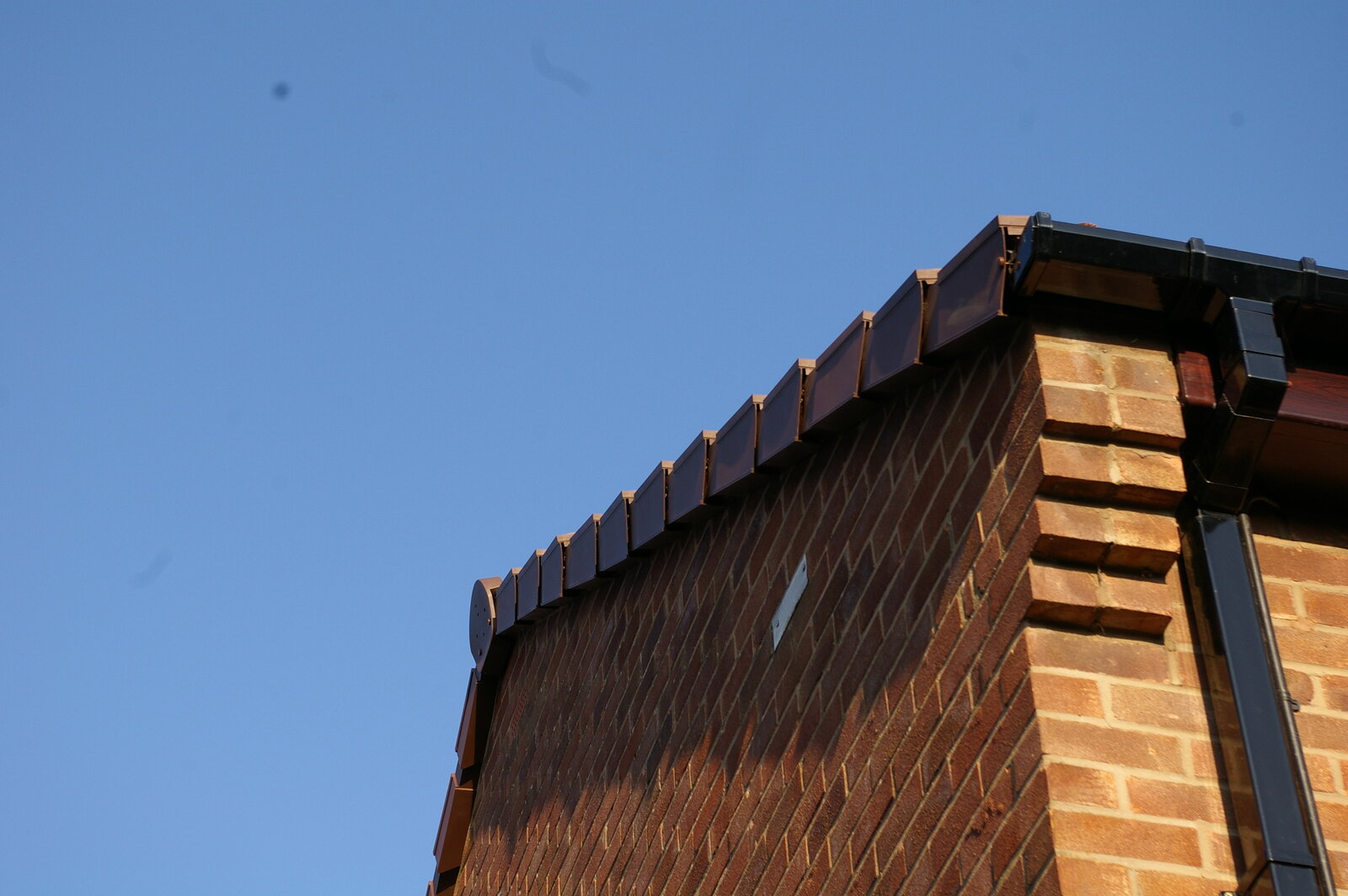

I'm looking at doing a much smaller low level garage roof myself to save money having paid over the odds for this, there are a few shortcuts I'm sure they took, can you see any more issues? For the money I was expecting a first class job, following the mfr instructions to the letter and doing everything they said (replacing the top rows of tiles with new matched for example).
Main queries would be
1. they used an easy-trim ridge f plus dry ridge, but didn't use the metal batten bracket straps. They said that this was because they were for "new builds", but I know that's not the case and the manufacturer says they should be used. They also gave what I believe was the real reason, that it would take longer to remove the 1st row of tiles in order to re-do the top batten with the straps underneath as designed.
I guess that they built up by screwing extra timber to the very top rather than using the straps to hold one in place, would this affect the installation long term, is it a standard shortcut?

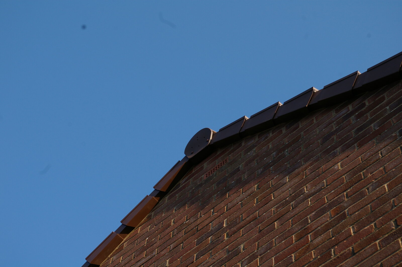

2. They used easy-trim ridge end caps, you can see that they seem to have added 2 screws where they don't normally have pre-marked holes. They seemed to have a bunch of marley end caps lying around too, but didn't use them.
3. They used a Marley universal verge, presumably this doesn't join to the easy trim ridge end cap as the easy trim verge would, will this cause issues?
4. I can't really tell whether or not they used the marley re-furb kits, the salesman said they do and there was a box of them on the floor but I didn't see them go on. I tried to take a photo up the inside while the starter kit was still missing, you can see something, but not sure if it's a refurb kit or not.
5. I can't see the bottom fixing bracket, it looks like the bottom verge unit is screwed to the gutter to me, but I could be wrong!
So, how serious are any of those issues?
