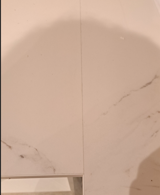

Just wanted people's thoughts on whether this is an acceptable worktop joint. To me, it could be better?
Not sure if colorfill would fix hide the joint a touch?
Loosen tne bolts, add colorfill and retighten.
As good as one can do a joint on white worktops, it will always show.
Not immediately but very soon after.
Unless it's stone.
Thanks both.
The fitter was trying to get that same point across, that the line will always show (even with a filler). Was wonder if another type of filler may work if it hardens enough? Probably being picky, but once he's gone, he won't be coming back.
You'll never get a perfect colour match so no another type of filler won't make any difference. Probably make it look worse if anything.
