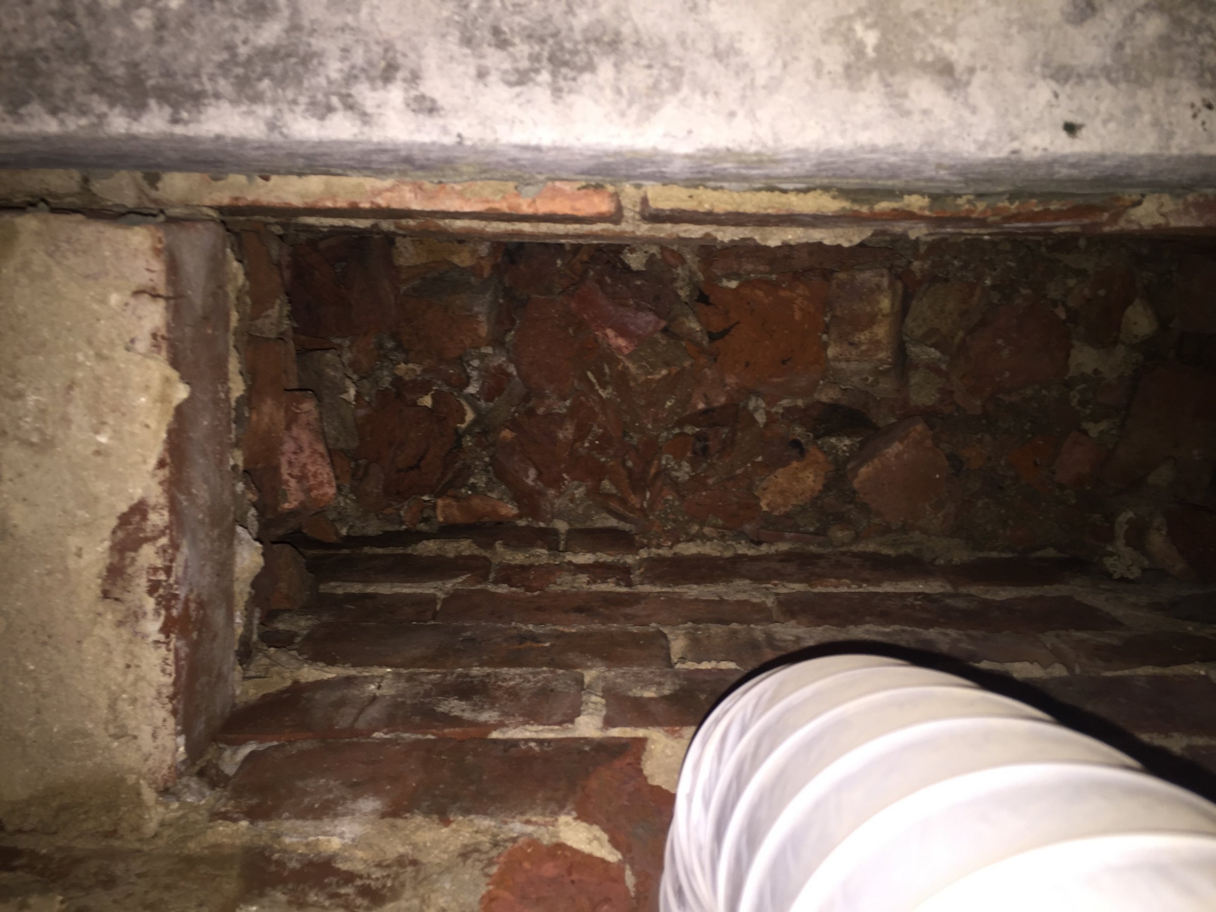

We recently had a ground floor chimney breast opened up for the installation of a cooker. The appropriate steel has been placed across the top of the opening. However, I am worried about bricks and building materials higher up inside the chimney which don't appear to be supported with anything.
I've attached a couple of pics.
The flue for the ground floor fireplace runs up the left hand side, then there is a column of bricks (which now seems to just be hanging) with two thirds of the right hand side being filled with brick rubble a bit higher up. I'm assuming the right hand side 'stuff' is for the first floor fireplace (not in use), but again, the rubble appears to be hanging without any support, and if I poke it (gently) brick debris falls down. Should something have been done to support this internal brickwork? What should I ask the builder to do?

Yes the bricks shouldn't just be held ú by the mortar, won't need much to stop them dropping down. If the builder didn't do the column of bricks out he should have supported them.
It won't need much, if it was mine even a couple of bricks or similar cut into a hole each side and mortared in and packed above with dry mortar would be enough. Prop them first in case they drop on your head while you're doing it though.

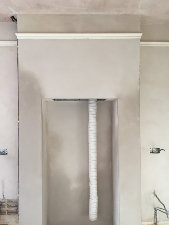

Your pic shows a cooker extractor flexi vent - its an unsuitable vent for a number of reasons - solid wall venting is best.

Thanks for this. I've attached a pic of the front of the ground floor chimney. The bedroom fireplace is completely bricked up and plastered over so there's probs not much point.
Does the chimney need sweeping even though we're not using it - we're venting directly out on the other side? The stack has been removed above the roof line.

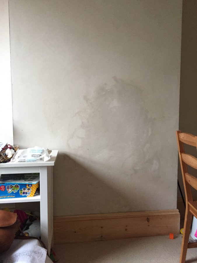

Here's the bedroom chimney. The darker patch is where the plaster was patched.
All redundant flues need venting - your two flues each need a bottom vent.
You appear to have used gypsum plaster on the chimney breasts and in the opening - lime/remedial render should have been used.
Given that the jumble of off-cuts and mortar has lasted this long, then there's no reason to disturb it now.

The jumble you are looking up at is inside the bedroom c/breast - its the base of the upper flue.
The builders have removed some of the "Feather" and the left hand flue "Throating" - neither would have been supporting the jumble.
Feathers are often built into the surrounding brickwork.
Your "feather" is the RH wall of the single flue - you only have two flues in the c/breast from the bedroom up.

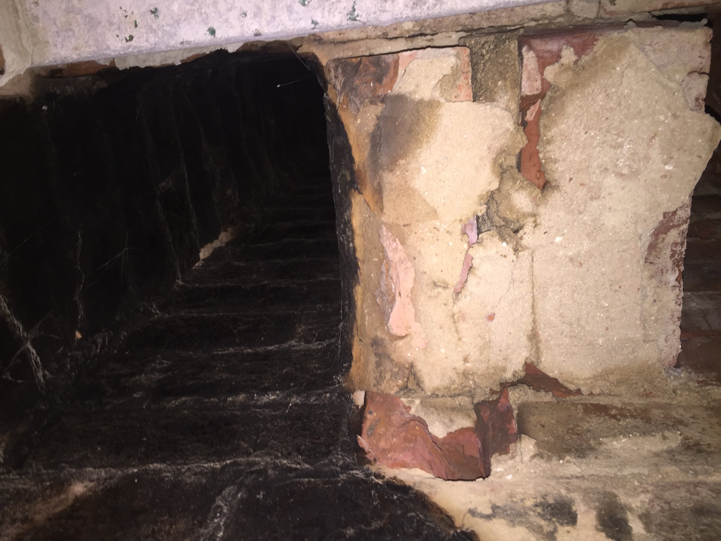

Aah that makes sense! Thanks. So the jumble I'm pretty ok to leave? The other brickwork is wobbly (the column bit). Should that be supported as it's no longer part of the larger structure below it? Thanks!
What "column bit" are you referring to?
In pic1. looking up you can see the jumble, and on the left the feather.
Its a bit late in the day for remedial measures - & how come you are having to give direction to your builder?
Someone has unsettled the brickwork without thinking through what they were going to do next.
Any work eg. a short L-bracket would depend on how much access you have - perhaps best to leave it alone.
