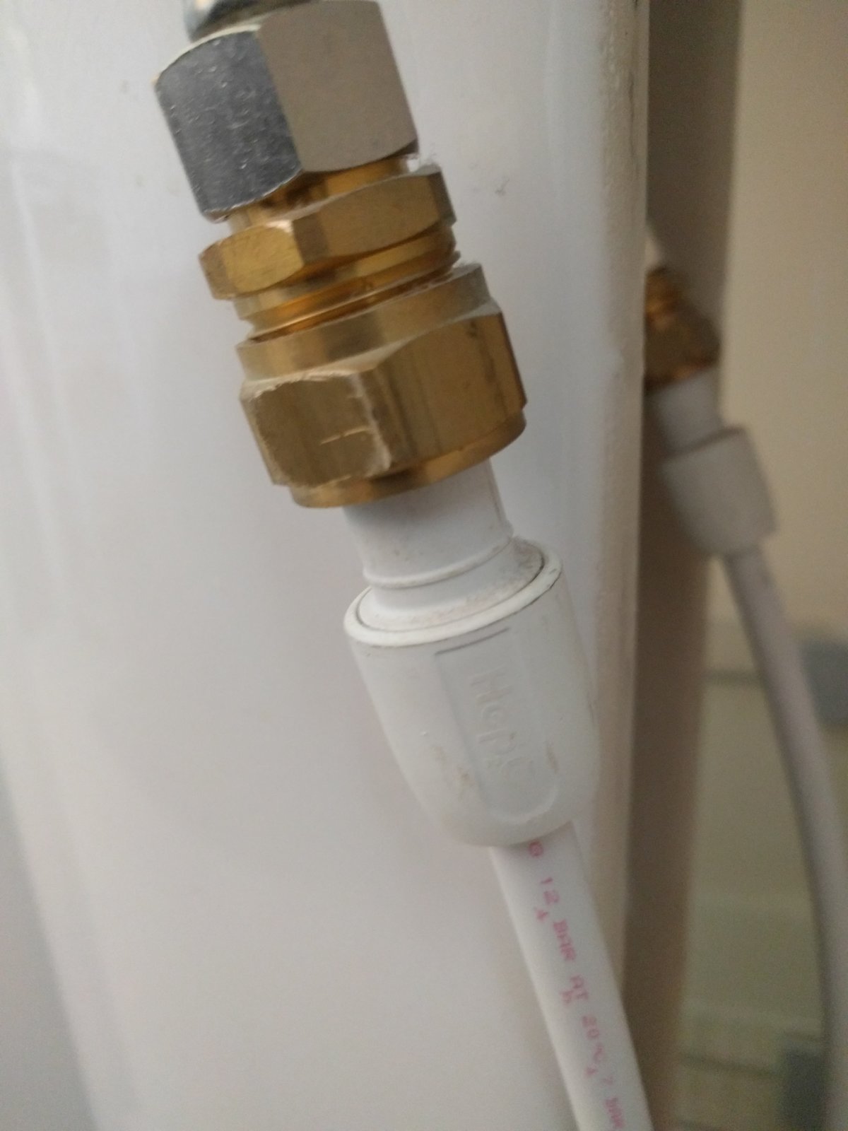

Hi all,
We're having tiling done in our 2 bathrooms soon & the tilers mentioned the taps have no isolation valves. Included a pic of what its currently looking like
I'm in two minds whether its worth adding them or not?
I was just going to turn the hot & cold water off them add a blank nut until the tiler had finished,or would it be worth adding in isolation valves for the future? and is so which would be best? adding in an isolation valve or could i change the flexi tap connectors and get ones with isolation valves?

Isolation valves are convenient , allow you to work on the taps etc ,without wasting water draining down or affecting the rest of the house plumbing. Full bore are better as they don't restrict water flow.

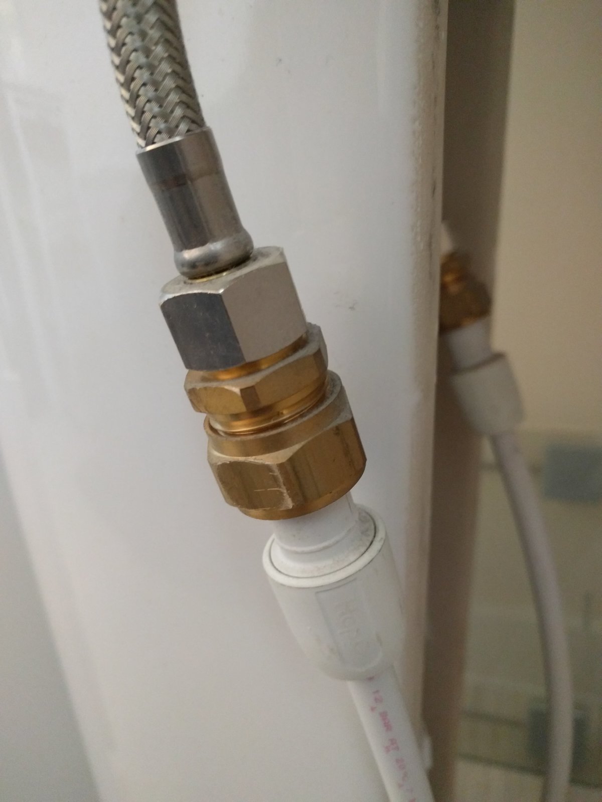

That iso is fine. Your plastic supply pipe appears to have a push fit tap connector fitted ,then a reducer then the flexi hose. Pic isn't too clear ,but that's what it appears to be to me. Do you know if the thread size on the flexi is 3/8 bsp ? And is that flexi going to be used ongoing ? Anyway ,the white plastic fitting would have to go ,a pipe stiffener goes inside your supply pipe, the new iso valve gets fitted to the supply pipe. What you then need depends on your answers to my questions above.

I'm not sure on the pipe sizing where would i find that out?
I was hoping i could just attach the iso valves onto what I've currently got :unsure:.It sounds like a bigger job than i thought maybe i need to just get the blanking caps lol

Ha ha ,welcome to the world of plumbing !! Here is another conundrum ,where are you going to fit the blanking cap ? And what type were you thinking of ??

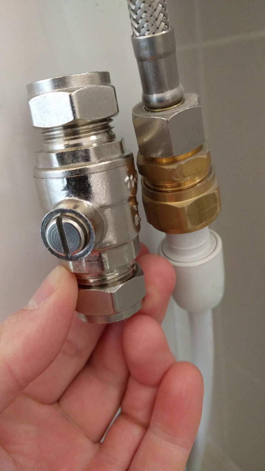

Fitting iso valve onto white plastic tap connector is a possibility ,providing threads on both are 1/2 inch bsp ,and tap con has a rubber washer .very good chance of this.

Careful when tightening ISO valves onto a tap connector, especially if it has a rubber washer (most pushfit use rubber washers). It's very easy to overtighen it, cut the rubber washer and then it'll never seal and you'll need to replace the washer.

Does that iso have a different thread on either end ,or is pic deceptive ? Do the cold mains first ,and when ready to turn supply back on only open stopcock a bit at a time ,having a second person to observe your handiwork ,ready to scream out ,whilst you man the stopcock !! :LOL:

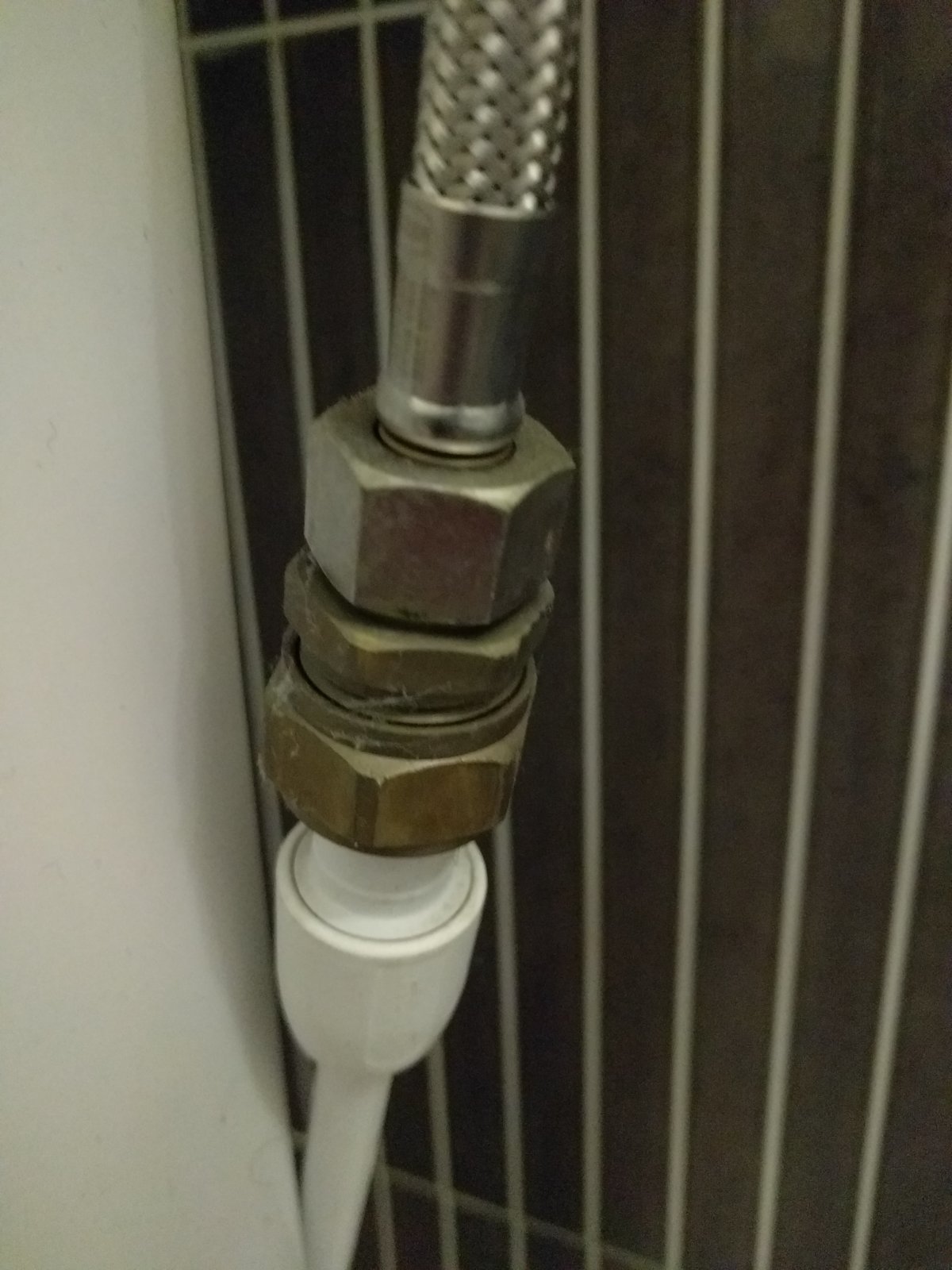

Hoping ive got the right iso 15mm full bore. Sounds daft but the brass fittings go.....?

The nut and olive are not used to connect to the white tap connector, screws straight in ,rubber seal should be in the brass nut of the tap con. So after turning water off and draining down ,you undo the flexi hose off ,then unscrew the brass reducer from the tap con. Check rubber seal in place and screw in isolator. Is the new iso same thread both ends ? If it is you will need another part to connect the flexi hose to the isolator.
