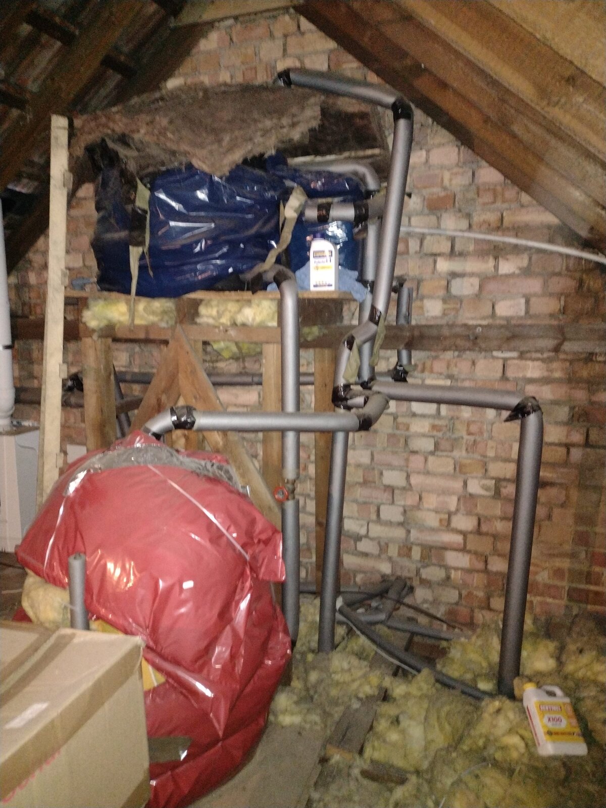

Rather than buy an expensive pump, would getting a larger tank placed as high as possible increase the pressure much?
No, it would make virtually no difference....and water regs require a certain distance above cisterns for maintenance.

0.1 bar on hot water.

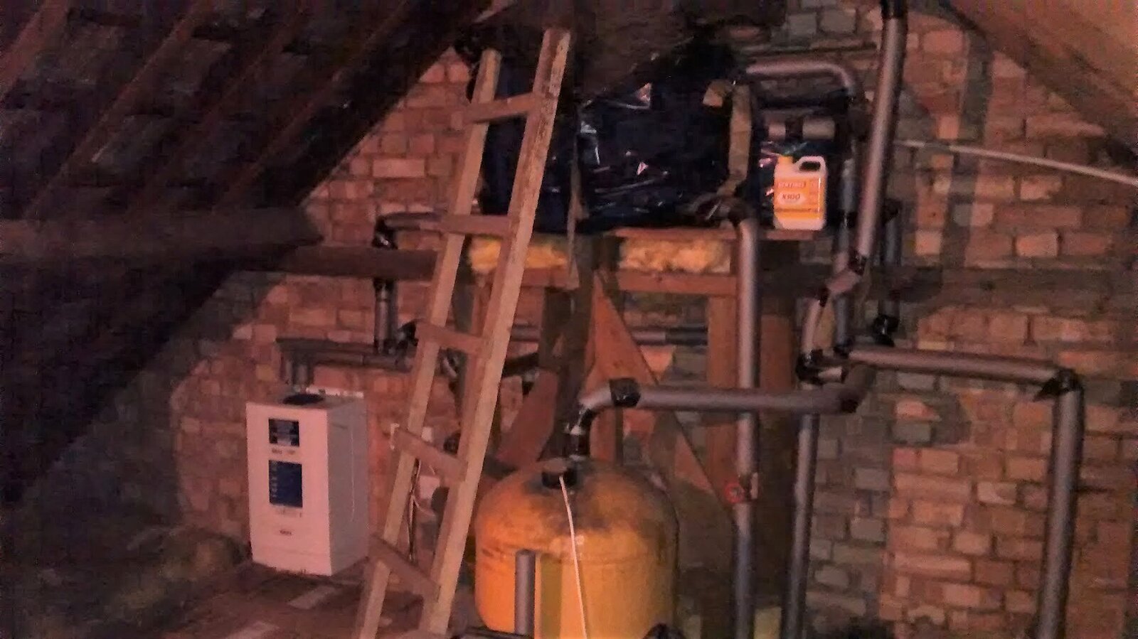

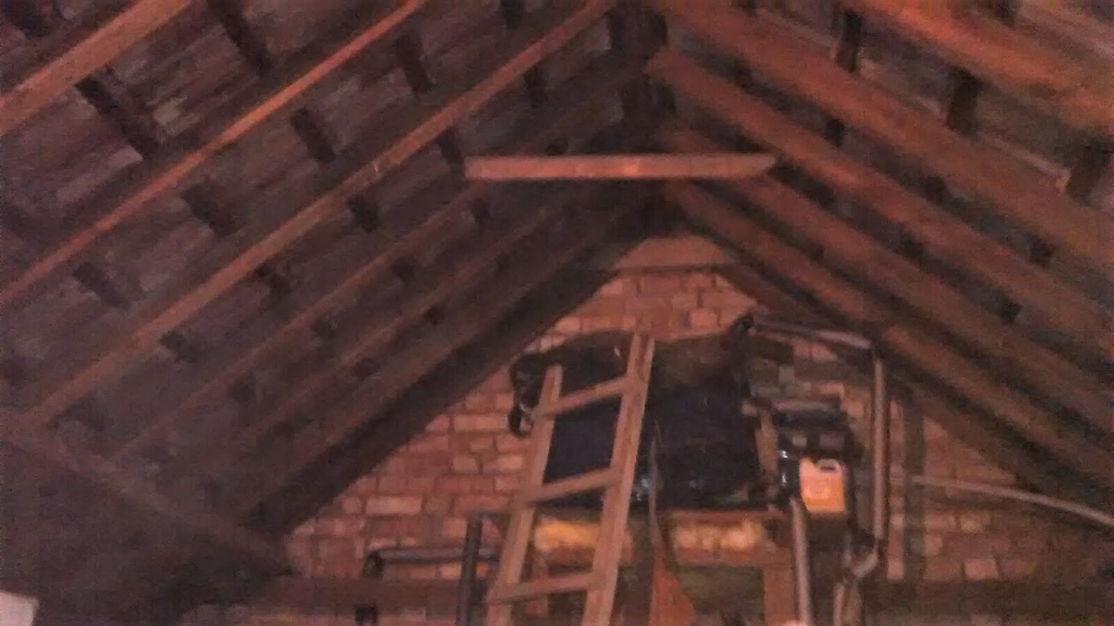

View attachment 248780 View attachment 248781
A larger tank makes no difference. The higher the better, but judging from the pics, you have something like 3m between tank water level and shower head. With the right shower that should give acceptable performance. I have about 1/2 that head, and while it's not a blistering shower it's perfectly adequate.
that's what the pressure meter read on the shower hot pipe
Looks around 2.5m between the cistern water level and shower head but after the head loss (friction from pipe and fittings) you've got next to no pressure left.

In a bungalow, and the hot water tank in loft on main floor joists - so distance from the bottom of the tank to the shower head is probably around 1m if that

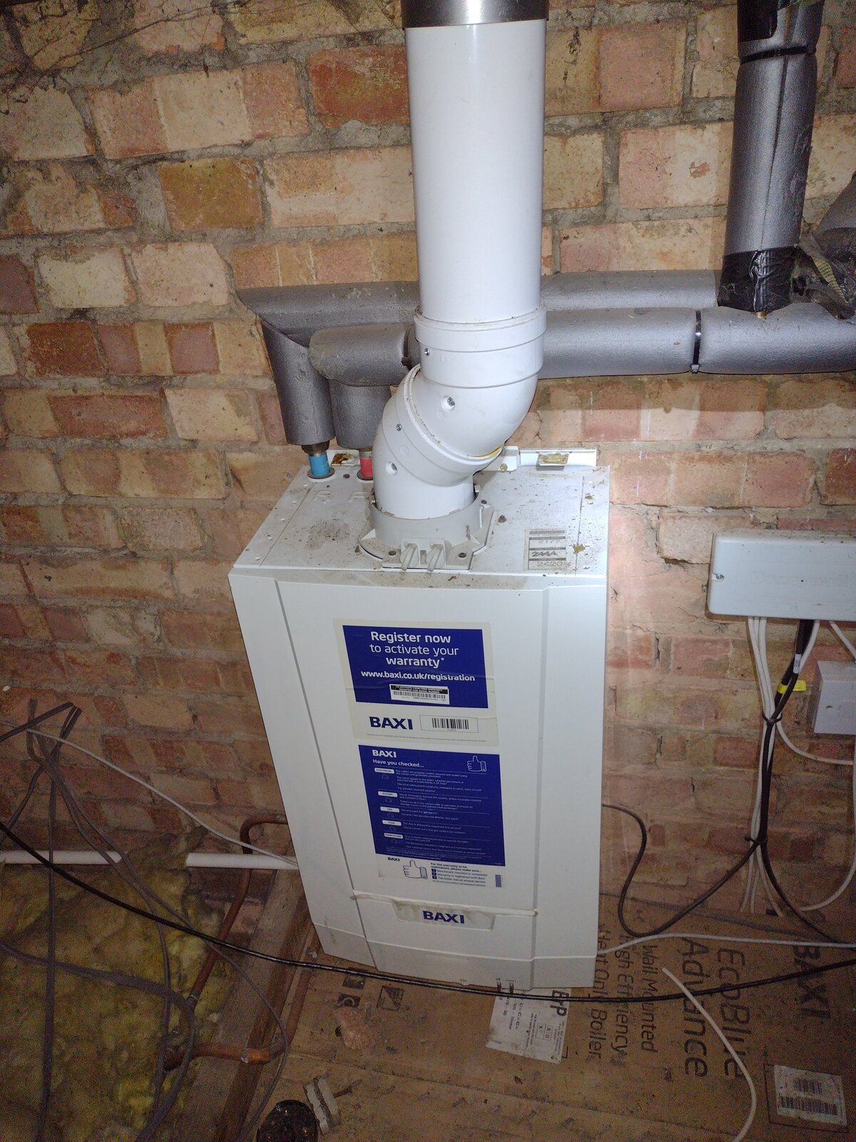

I looked at pumps, and to use a pump, i would need to change the hot water tank, to have more capacity.
Yeah, I am happy with the shower to be honest, in fact, I don't have a problem with it at all, but you know, the wife mentioned it.

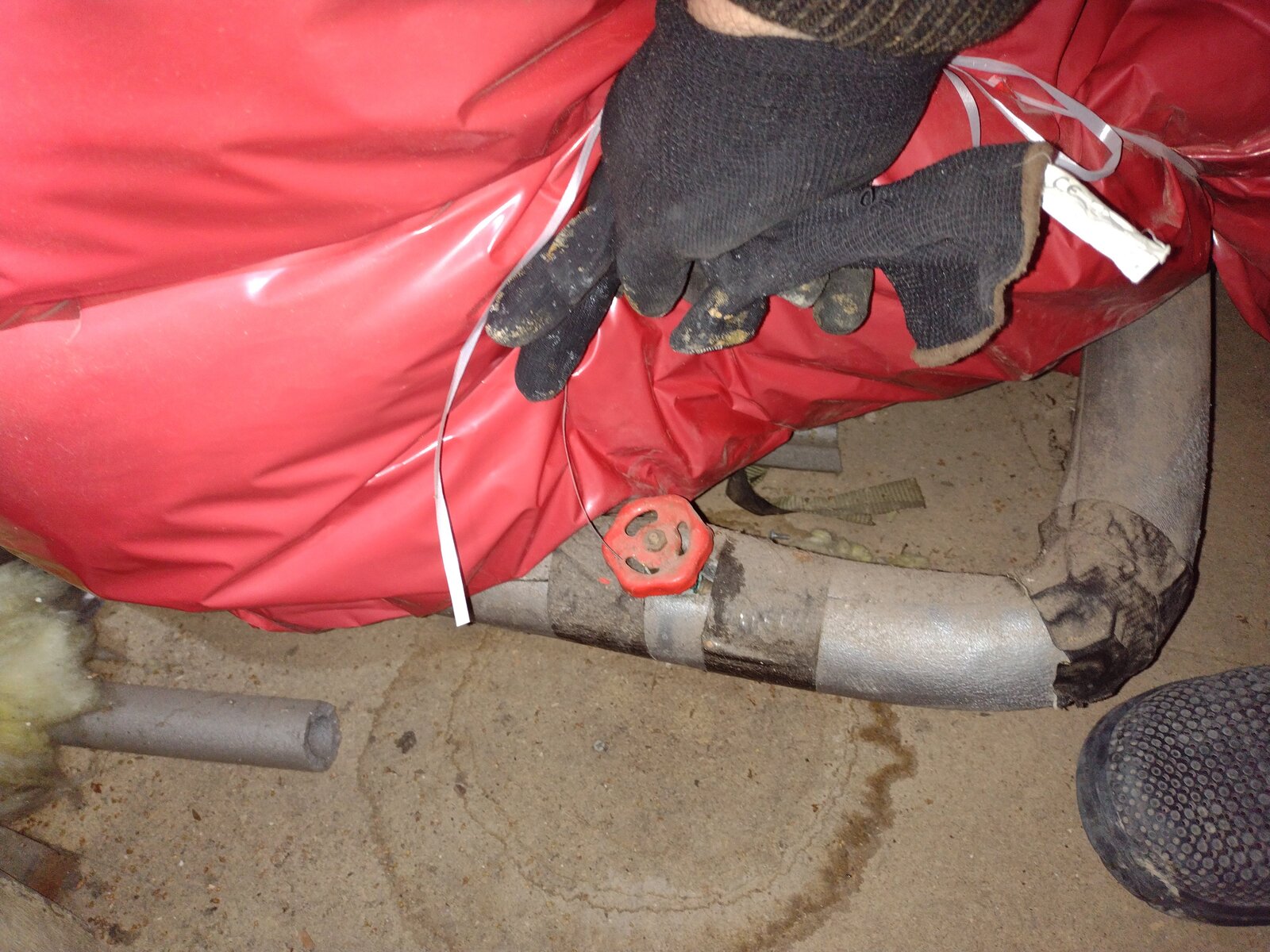

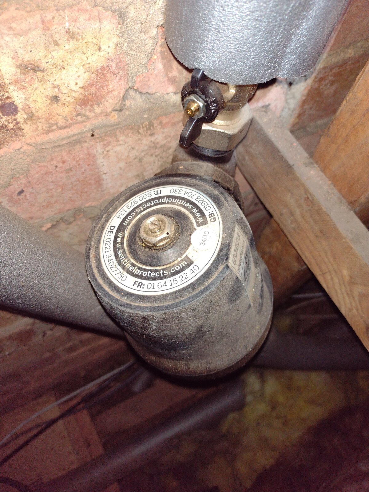

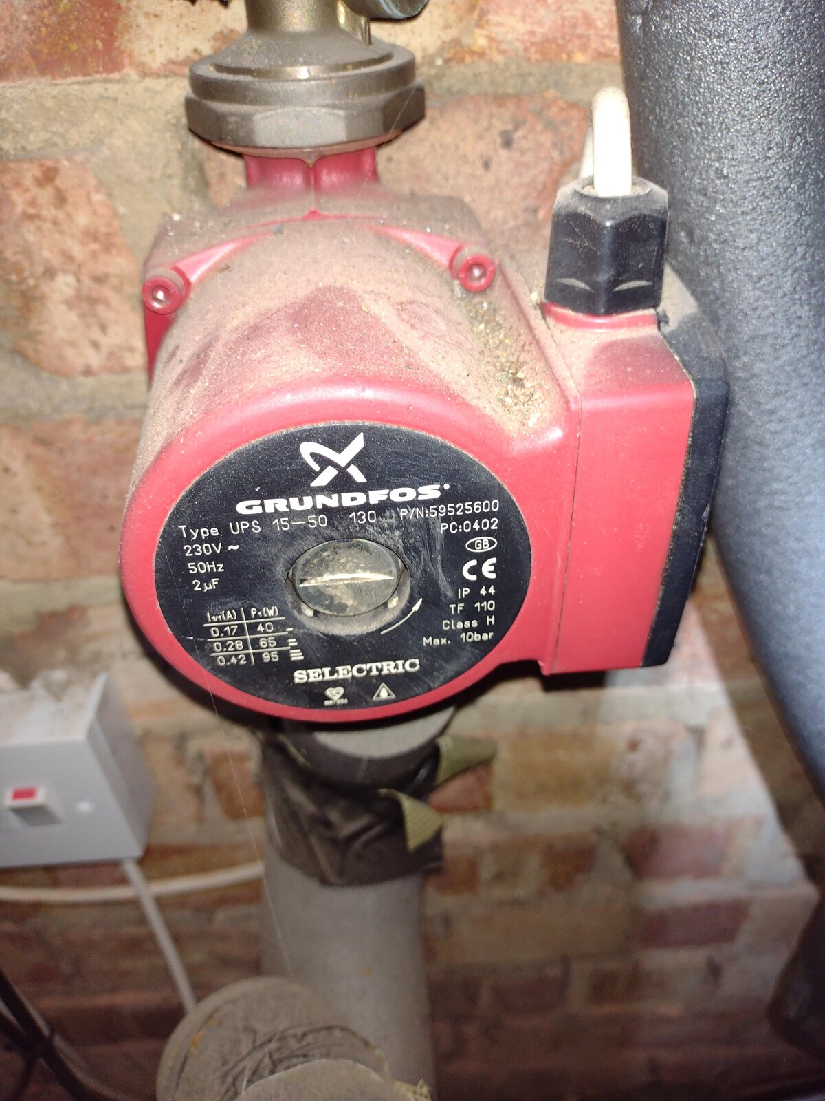

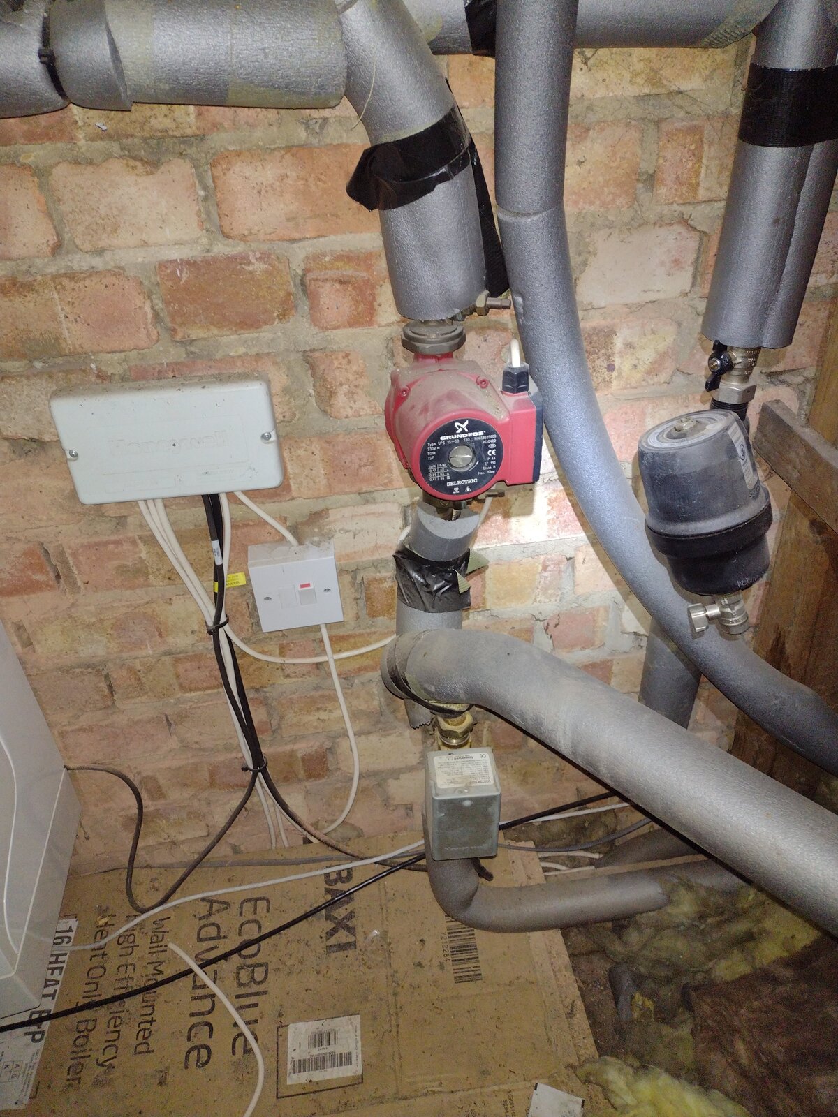

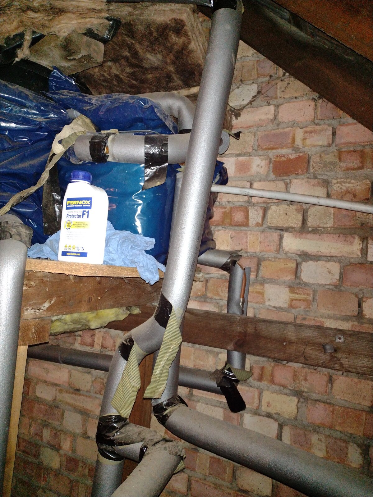

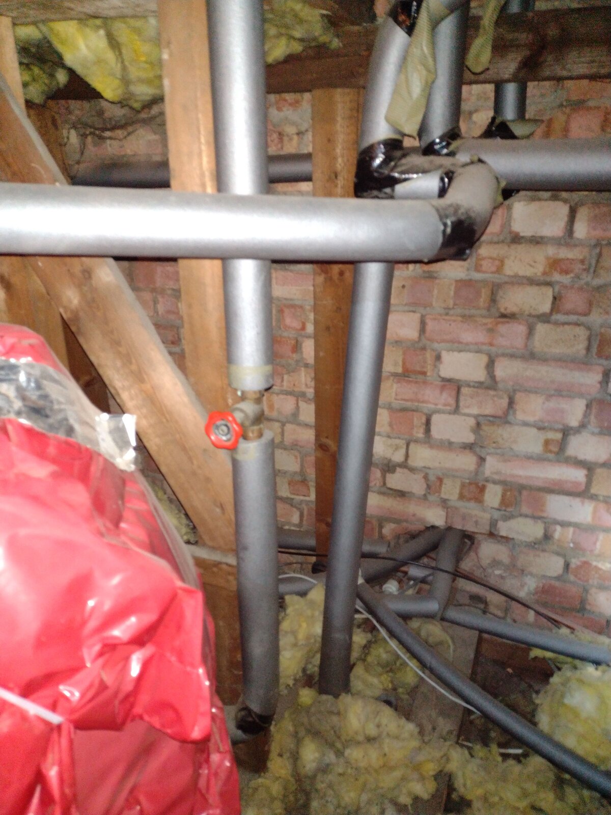

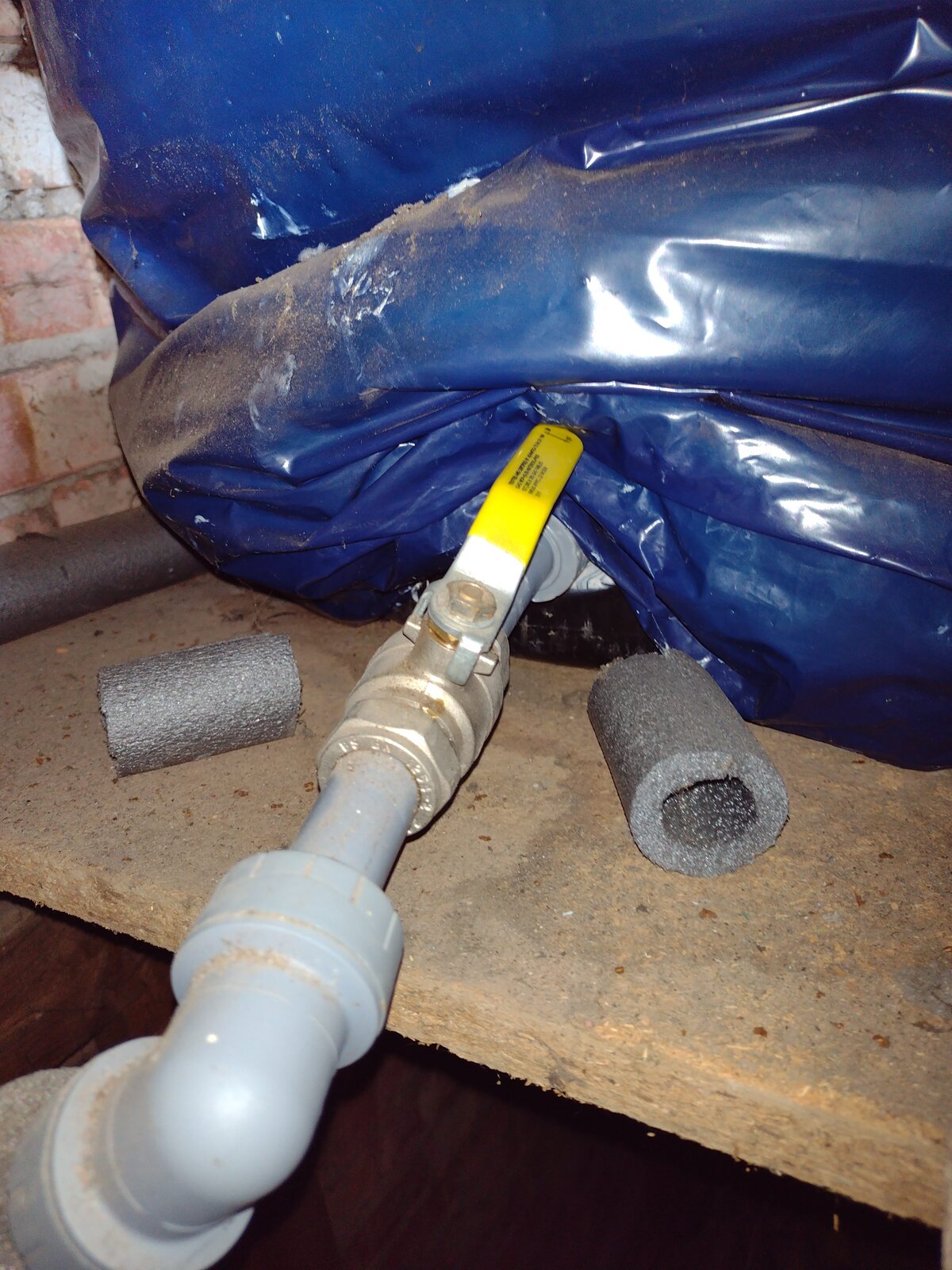

I just had a look up there and as far as I can tell all valves are fully open.
Some photos of various things, mostly I don't know what they are or what they do! The round red valves were fully open anti-clockwise though
This next one felt quite loose - open, but just a bit loose/wobbly
