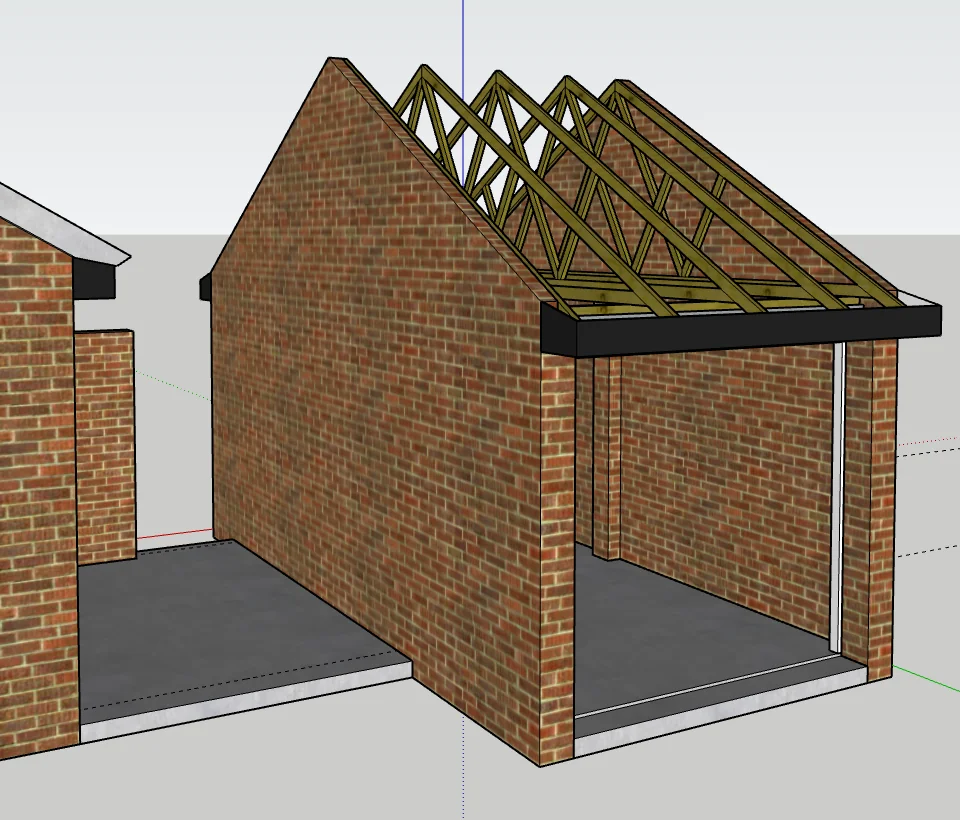

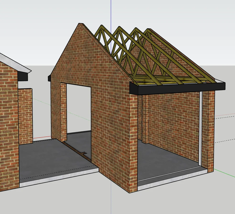

Would it be possible to make an opening like this in the side of my garage?
20 May 2024
3

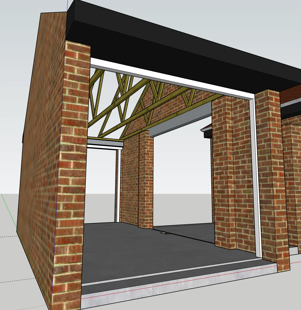

It's a detached garage with "side gables" and doors at each end. I'm thinking about extending it out to the side, and wondering if I can create an opening like pictured. The roof structure is supported by a lintel at each end above the doors, and those lintels rest on the corner pillars.
The total wall length is 5.5m, and the opening would be about 2.4m and 1.1m from the corner. Would a steel lintel and brick piers either side of the opening be sufficient?

It's a garage. The new opening has a triangle of bricks above it. I'm sure the the answer is yes as far as the opening is concerned. I'm no structural engineer, but I've more concern on two parallel walls with large doors each end - where is the lateral support, opening or not?
It looks like the setting for that famous Buster Keaton stunt in Steamboat Bill Jn where he is standing idly dreaming and doesn't notice when a wall falls on him as he just happens to be standing framed by an open window.

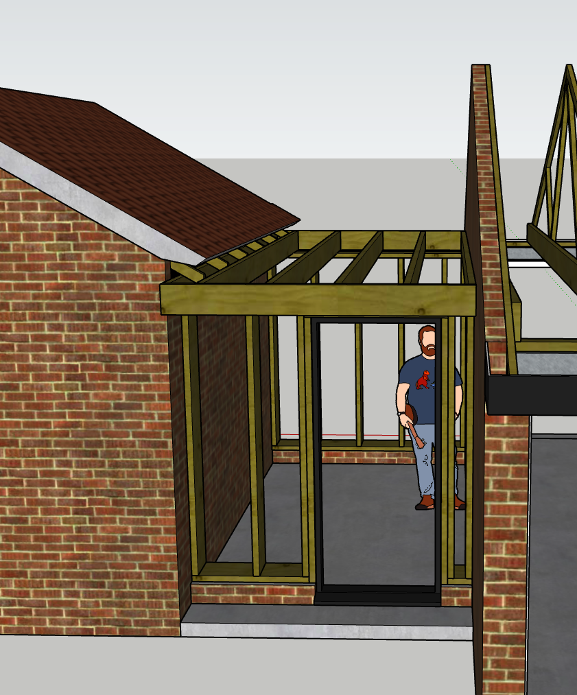

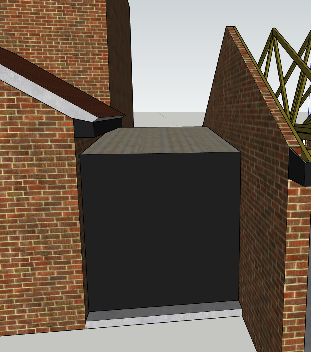

So the ultimate idea is to build a "shed" to the side that is joined to that garage. Currently there's a shed standing there that looks something like this.
It has a roof that slopes from front to back, it's very low head hight at the back and the whole thing leaks, so it's slowly rotting away as a result. I want to replace it with something like this:
This would be a "garden room" type structure, but it connects to the garage via that opening, allowing me to use it all as one space. The use would still just be a garage/workshop, and there would be no access to the house. The roof of the "garden room" part would join to the roof of my existing house extension, basically just an EPDM roof joined at the eaves so the rain water from the extension runs on to the flat roof.
What are the thoughts on this? I did a bit of research and felt like this falls in to permitted development in terms of sizes and structure, but the two things that are a bit different to normal garden room builds is that it's connected to the garage, and requires that opening, and that it "connects" to the house as part of the structure.
