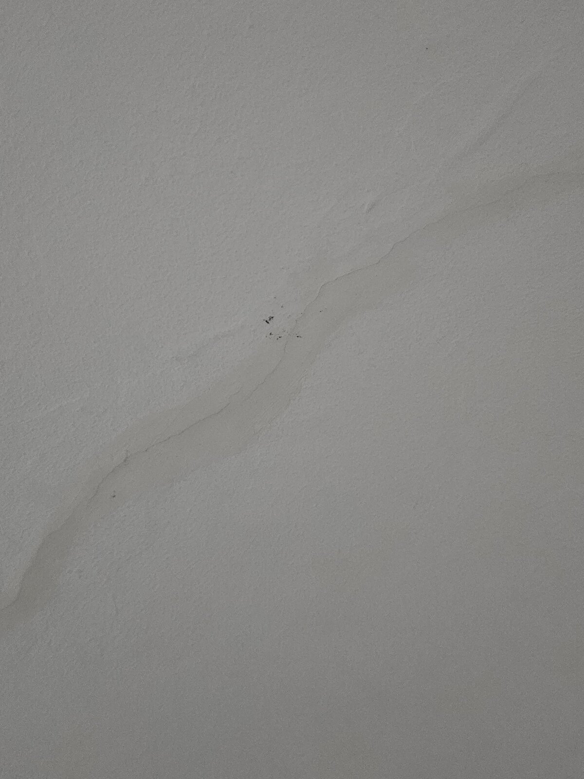

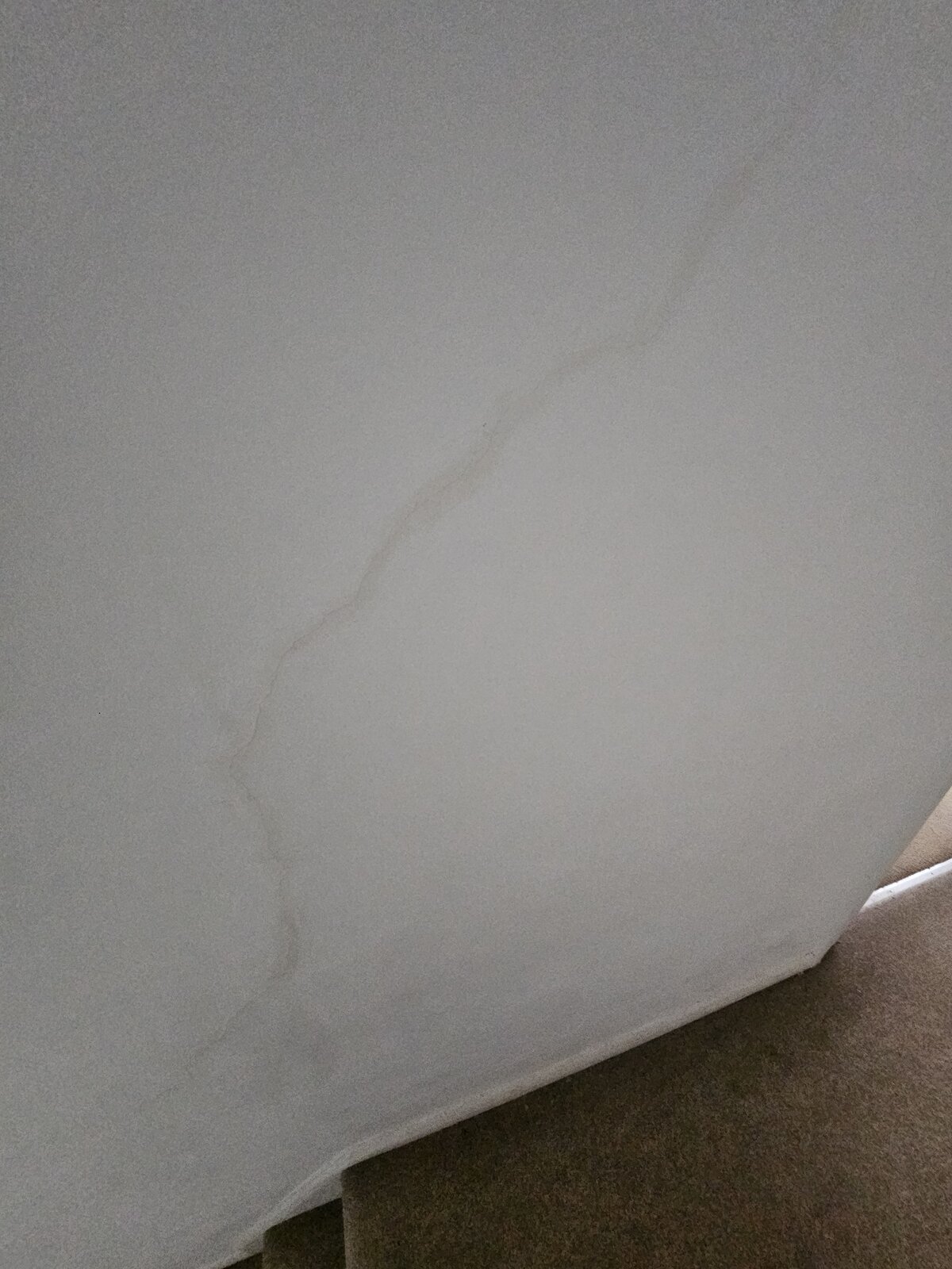

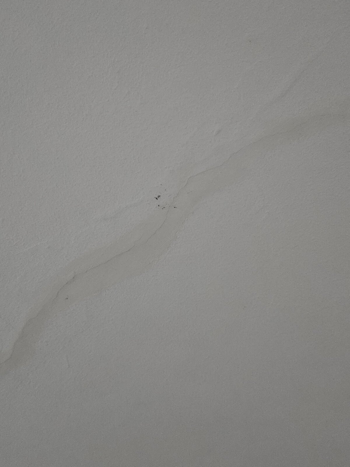

Would you just paint over this ? I dont know the history of the crack
26 Feb 2014
15
London
what would you do with this crack. I'm not sure if its been filled as i didn't do it but its still noticeable. I don't know whether to just paint over it or to open it up and then fill it with plaster and then paint it. :confused:
Presented with a crack like that in plaster, I would enlarge the crack, brush in dilute PVA (in the hope of "gluing" the edges of the loose plaster to the brickwork). When dry I would fill with toupret flex and fill (it is available in tubs or caulking tubes). It is like a caulk with reinforcing fibres. Like caulk it shrinks back. Leave it for a day or two to shrink back. Then fill with a filler of your choice.
I have only been using it for about 5 years, I have been very impressed with the results. Particularly because I haven't had customers phoning me to complain a year or two down the line.
Oh yeah. It's a wall. Oops!
I'd do it differently by knocking off the plaster. Bricks are probably cracked so I'd fill those.
Metal lath screwed over.
Plaster.
Bigger job than filling though.
Also is it old lime plaster?
