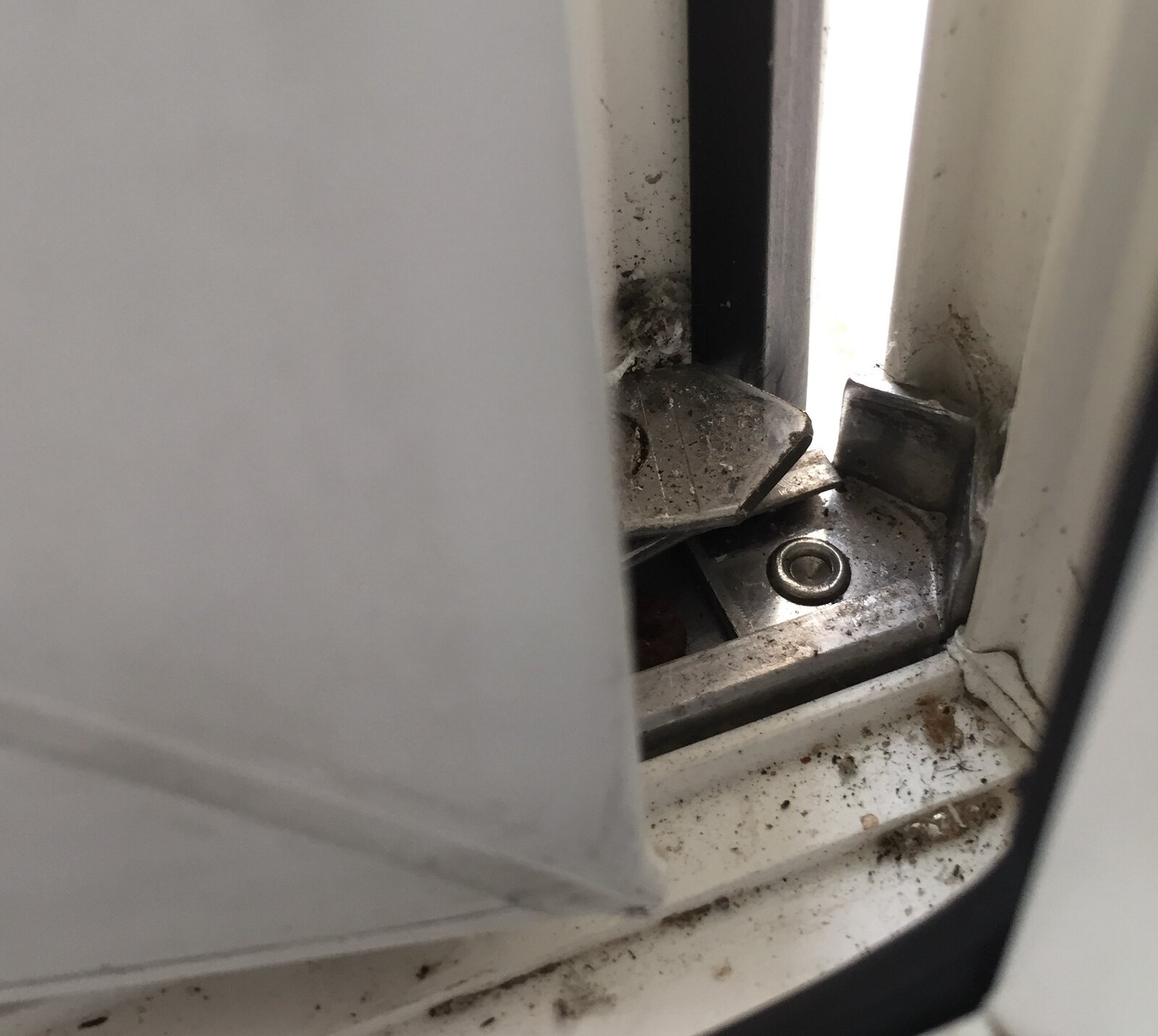

Here you can see the bottom hinge, I'm reasonably confident that the problem is with the 'V' shaped end of the hinge where attached to the sash and it's 'V' shaped 'socket'. When closing the window the 'V' meshes and closes the bottom nicely.

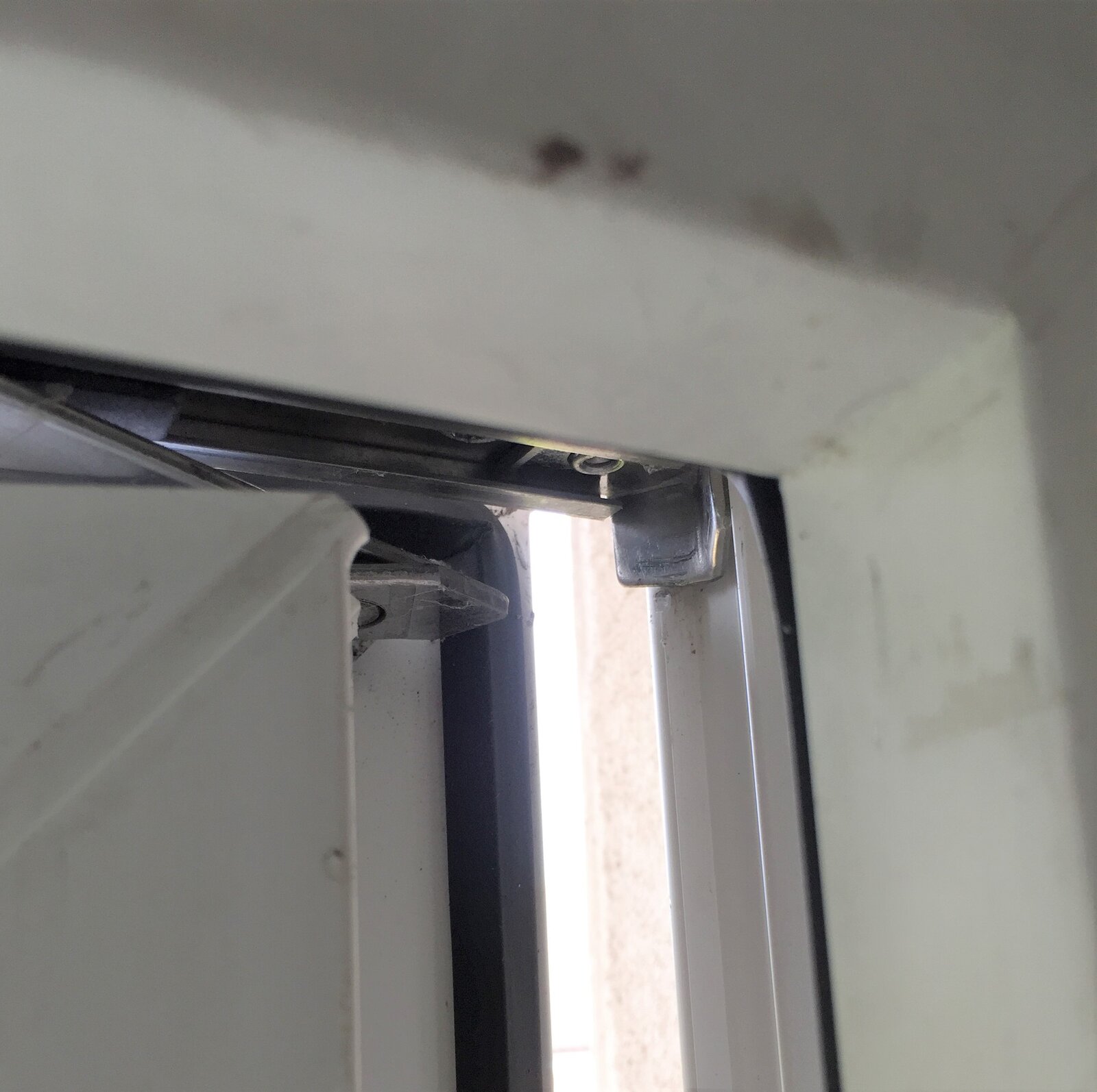

If you look at the same parts of the hinge at the top of the window it's pretty obvious that the 'V' parts are going to miss each other by around 5mm (sash side too low), the hinge is not being pulled into the frame like it should be.
So, I think I've worked out what the problem is but I have 2 questions:
1. Why would these hinges be used when they appear to be incorrect?? I'm reasonably sure these are the original windows (27 year old house) and, apart from the like for like replacement I made last year, the hinges appear to be original. The same hinges are fitted to 2 other double opening windows (that's 6 opening windows in total) and it seems the same issue applies to all of these windows to varying degrees.
2. What can I do about it? My first thought was to get some packers to give a bigger stack height. What I need to do is move the window up but using packers top and bottom will effectively keep it where it is. If I do move it up by packing only the lower hinge I risk the 'V' parts not meshing on the bottom. ** Second thoughts, I suppose what I'm trying to do is increase the distance between the sash mounted parts of the hinges, maybe packers will work??
The (17mm) hinges don't sit in the channel of the outer frame, they sit 'on' it, they appear too wide for the channel. If I install hinges that will fit in the channel (13mm or possibly 15mm wide) the problem will be exacerbated by effectively lowering the stack height further. I'm bemused by this. It's almost as though the sash is too small for the frame and it's been bodged in using the wrong hinges, this was probably ok for a few years when new but normal wear and tear has led to very obvious gaps.
