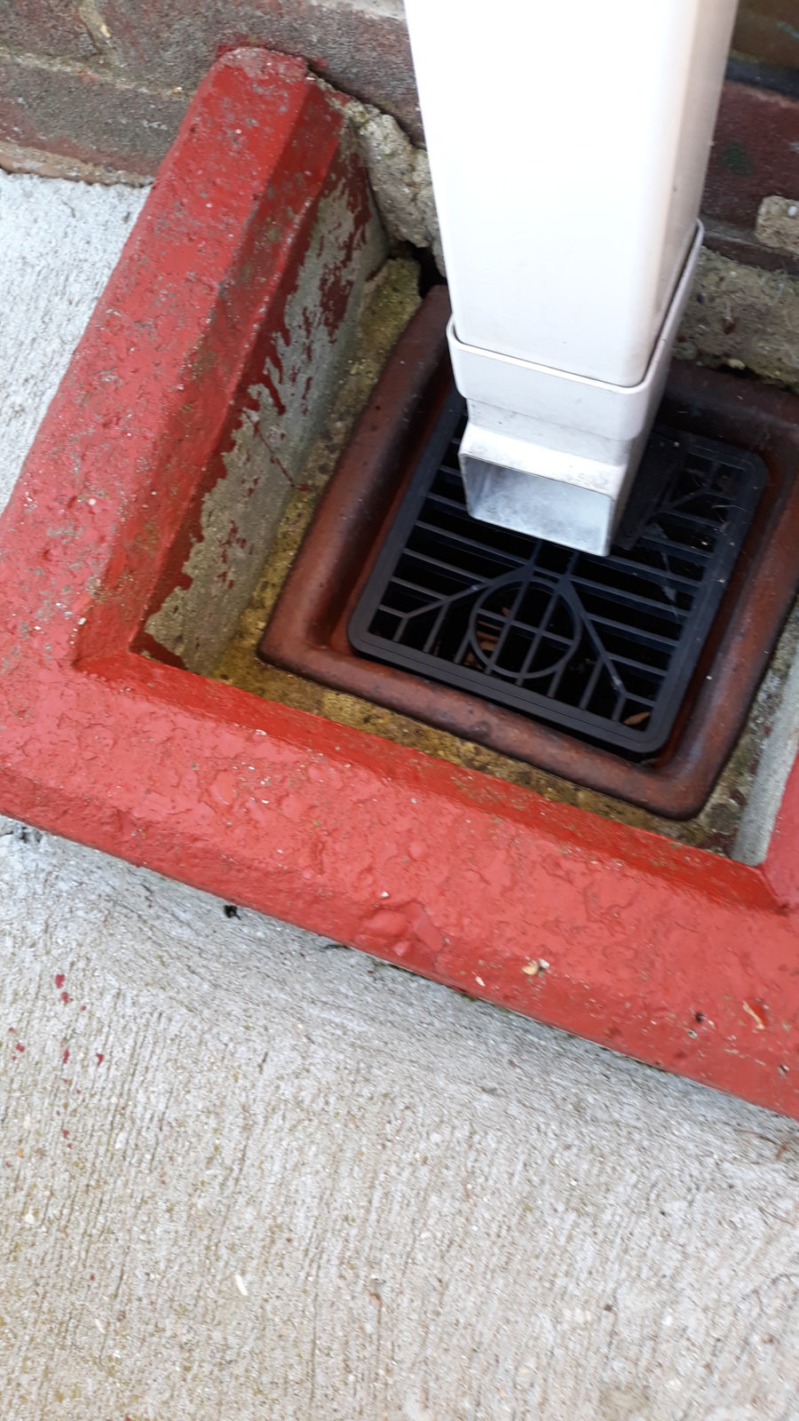

Hello, On a survey recently conducted on my property (for my buyer), the Surveyor has put that the two downpipes are wrongly discharging? From the picture attached I can only say that this is how they both look/are, going into the drain. Can anyone tell me what he is on about please?

Are they discharging into foul mains drainage when they should be going to soakaway or storm drain
Thank you for your reply. I have always thought they were surface water drains and however the set up is now, it was built this way, no changes to drains have ever been made to my knowledge.

Thank you so very much, very informative indeed but if this is what the surveyor is on about why would he raise this as a defect with the property. I mean if this is how the build was done then so be it!??? ?
The only thing I could think is that he wants a straight on the bottom into the grid rather than the ‘shoe’ fitting.
It’s not an issue.
Can you ask the buyer's surveyor what they mean exactly :?:
Thanks solved! Seems the surface water is not going where it should which is why he said "wrongly discharging". Its the way the sewage company have routed it.
I suppose the obvious questions now are where is it going , where should it go and why wasn't it discharged correctly in the first place ?
