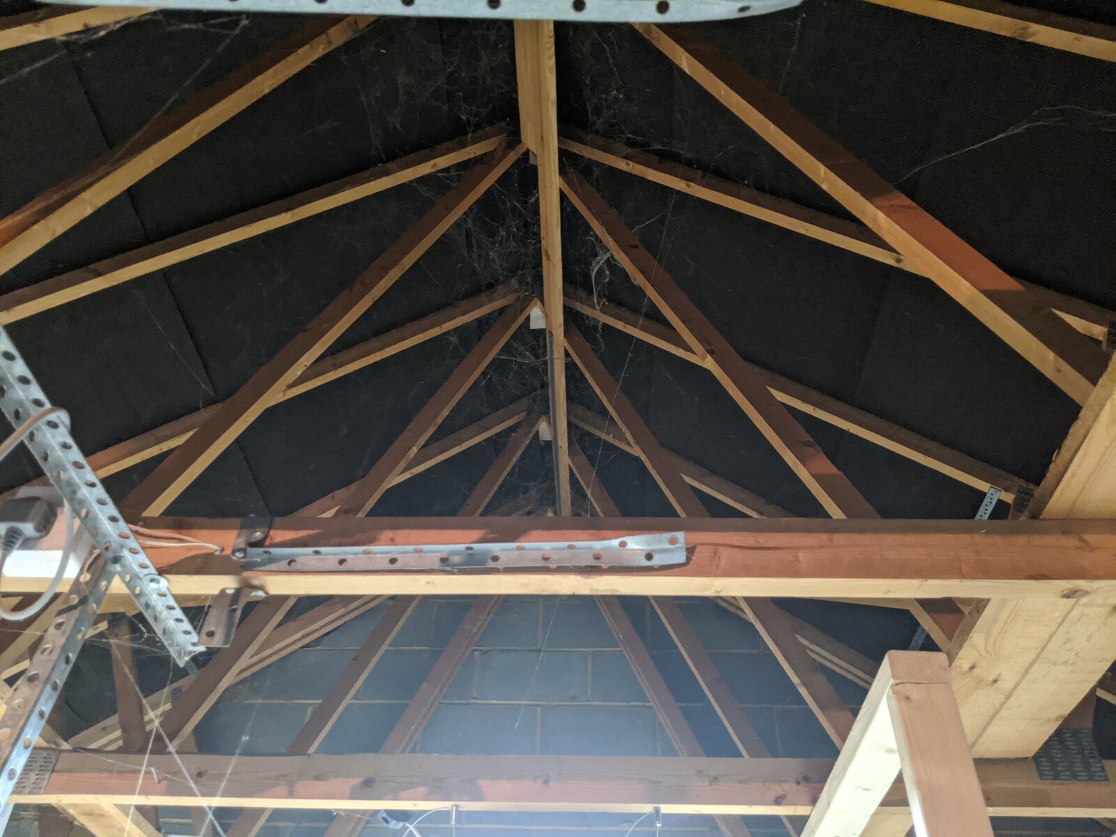

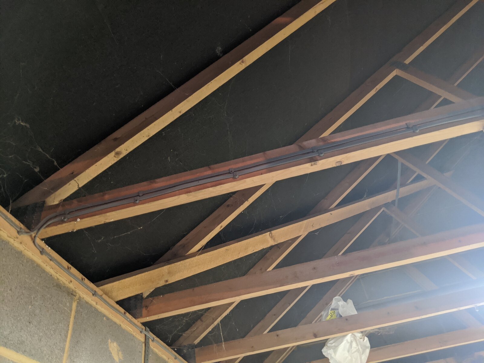

I'd been leaning towards insulation at the rafters to keep the useable space on the joists, but realistically it's mainly for cr@p and I haven't got much up there! With pragmatism in mind, I'm thinking I'll probably plasterboard the ceiling, insulate on top and board out the middle stretch for storage.
Any thoughts if need to be concerned about the bearing capacity of the joists?

What are those joists, look like 6 x 2 at 600 centres? Plasterboard and insulation would be ok but i wouldn't put a lot of weight up there on a 5 metre span, they might be a bit baggy, probably only there to tie the rafters in
