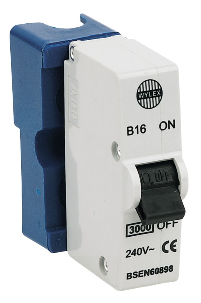

I have recently been doing some renovation work on my kitchen and have noticed that the dedicated cable from the Wylex fusebox to my single oven is using 2.5mm cable which I believe is rated 26amp. That's fine because the single oven is only 10amp, but the fuse in the box is 30amp.
Is that a mistake or what you would expect to find?
Presumably I should change the fuse for a yellow 20 amp Wylex fuse?

In that case then, assuming the cable is not running through thermal insulation or the like, then a 20A rewireable fuse would be fitted as a matter of course.

No. Rewirable 20A fuses cannot be used with 2.5mm cable.
A cartridge fuse or circuit breaker might be suitable, but changing devices in an obsolete fusebox will achieve very little.
If you want a higher rated circuit for a double oven or cooker, then a new circuit is required, and a new consumer unit to go with it.
Rewireable fuses have a much higher fusing factor, typically around 2, and cable ratings based on those for circuit breakers must be reduced accordingly.
Assuming best case for 2.5mm² at 27A with a circuit breaker factor of 1.45, that's only 19.6A, which rather obviously is less than 20.
Although it's a small difference, it's below 20A.
