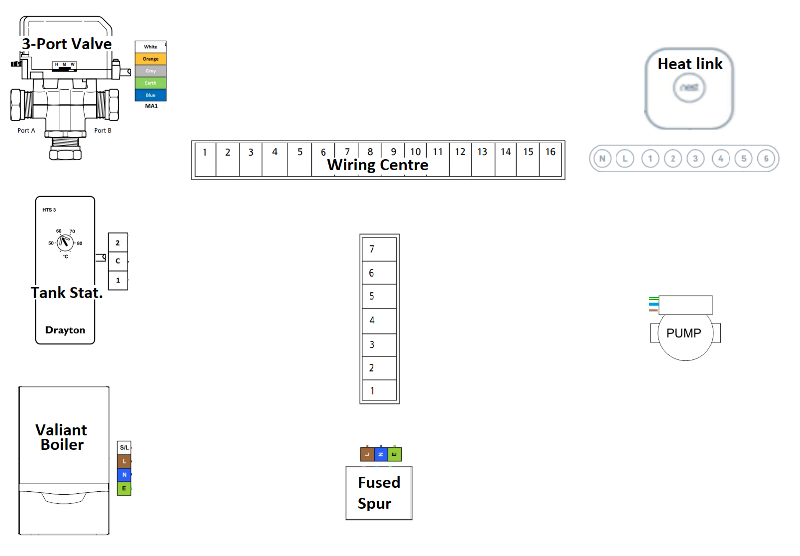

Please can you knowledgeable people take a look at the below wiring diagram and tell me if I have got it correct? if not I have supplied a blank layout for the lines to be drawn so to speak.
Thank you in advance
Paul.

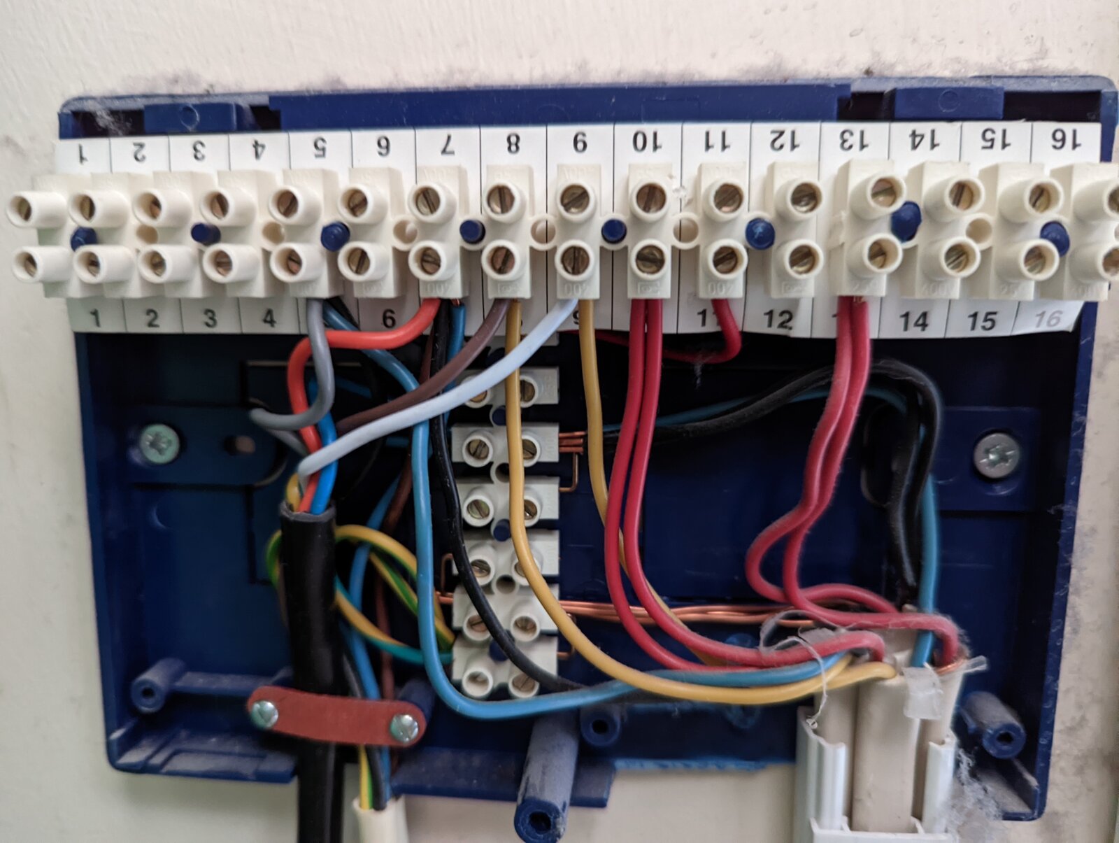

Current mess!
Cylinder thermostat 2 isn't connected to anything - the wire is shown as going to 16, which connects to nothing else.
Needs to be connected to valve grey, so 7 or 8.
Diagram also shows no pump overrun, which was common with old boilers but far less likely with a new one.
Ahh great spot, thanks for that!
I meant to put an extra line up from 8 to 16 as it passed by on its way to the nest but missed it.
Other than that does the wiring look right?
