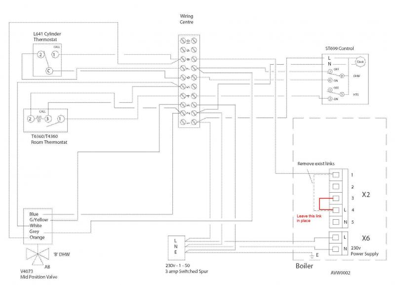

The boiler is a Broag Avanta 24S and X6 block is fed from Wiring Centre { port 8 }.
I knew it was wrong but when I set it up as per the handbook { removed links X2:1 to 4 and X2:3 to 4 then set permenant L/N/Earth to X6:1,2and3 then plugged port 8 from wiring centre to X2:1 as per standard y-plan } the boiler comes up , fires once then sits at 0 on the panel waiting to be called , however , when wiring centre pin 8 comes up to 230V it does nothing .
230V comes and goes with thermostats as expected , so I reckon I'm missing something on the boiler , any ideas ?????

Sorry forgot to mention I have already tried just removing 1-4 on X2 , still no joy ....
What do you mean by temp live to X6?
This should be permanent live.
You need a link on 3,4 of X9, which you say isn
't there but it is required, so if it is not there then that is your problem.
On X2 you must use one or the other of 3 and 1 as a s/l from the wiring centre,removing link at same time, the one you don't use must remain linked.
Wiring centre must be on same switched fuse spur for safety or send it a live from 4.
it's firing up the boiler from the 230V demand feed { from Wiring centre term 8 orange from 3-way valve } , but when I feed a permenant Live , place the 230V demand in term 1 on X2 and remove the links . It starts up but won't call CH or DHW
Best practice is use 1 on x9 as live in, leave link across 3,4.
The way that 3,4 and 1,4 work is that both have to be made for boiler to fire.
Sorry although I said X9 I should have said X2 that was just an error in typing. Otherwise your diagram shows exaclt what I have been saying, leave link 3,4 of X2 in situ and put the s/l into 1 of X2 after removing the link.
