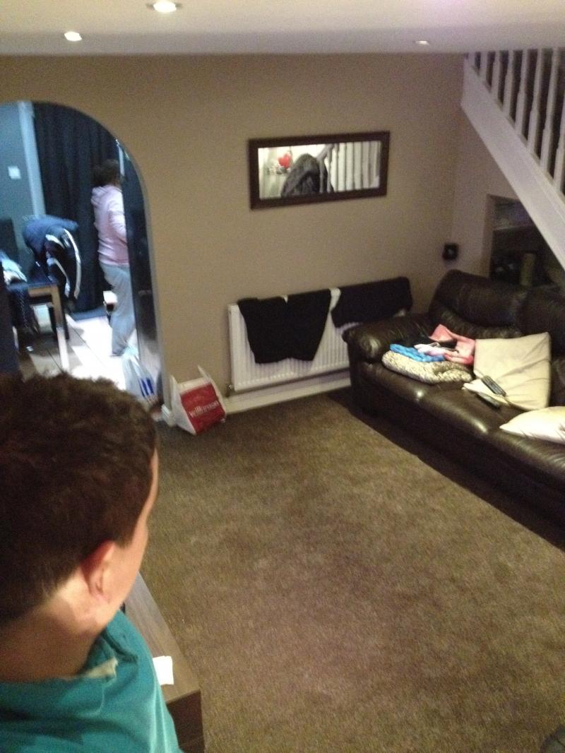

Hi all, ive had a YALE 6400 WIRELESS ALARM fitted for around 16 months and never had an issue, recently at random times, always at night possible once or twice a week the alarm triggers, sometimes the warning beeps wake me up but other times im not so lucky and end up waking the street, i have changed all of the batteries, the alarm trigger always comes from the same zone, i have even swapped the PIR with another and still get the same zone, we have no pets and i cannot see any bugs or spiders around the PIR, i cannot think what else it can be, anyone help me on this issue? oh and its never the same time or same day, its random.

I have it set as an entry as the stairs come down into the living room and the PIR picks up when i get up in a morning, and also yes i deleted the PIR's from the system and re-allocated them
The log doesnt go far back enough to the last time it false alarmed, but it always shows same PIR
what is in front of this PIR?
door, window, fishtank, boiler, fire, radiator, blank wall, catflap, mousetrap?
mmmm. radiator, mirror, doorway, window beyond.
does it help if you move it?
I have PIRs pointing at similar things, and mine don't go off (but I was told not to point them at windows). You say no pets? do you have children? does it go off when the house is locked up and empty?
haven't you got a door sensor you can use as an Entry device?
The front door is set as entry but thats no good if i come down the stairs and trigger this PIR, the alarm was fine for the first year of it being fitted and nothing has changed in the living room that i can think of, no kids, no pets
The radiator doesnt come on during the night, window in kitchen has curtain closed, reflection in mirror cannot see an uncovered window
how would it be if you set that one as a "home" sensor?
