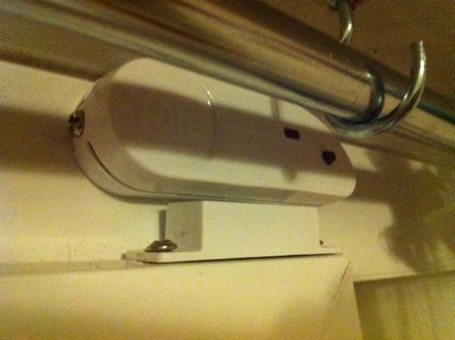

Hi,
Struggling a bit with this as just recently after perfect operation 1 out of the 4 door sensors on my Yale 6400 only intermittently reads on the walk test/triggering the alarm.
I've used the test button on the sensor itself which appears to work perfectly and i can hear the slight *click* every time the door is used (which rules out a fitment issue) but I still get the problem above.
I've also tried the standard stuff like replacing the battery, removing & re-adding the sensor into the system and moving the location of the sensor.
Any ideas or similar experiences? on a whole I'm very please with the alarm which is which is why its bugging me so much.
thanks
Dan

Hi
thanks for your reply (i would have replied sooner but the forum doesnt allow logging in from an iphone).
i've tried swapping the sensor from a working door and the problem stays with my upvc sliding door unfortunately so that rules out the sensor itself.
ive tried it both on the leading edge of the door so that it meets the contact aswell as at the bottom & top (as in picture) so that it slides away and definately not more than 8mm away.
im putting up a PIR to cover the area but really would like to get it working but am struggling to think what the problem could be? as far as i know the frame is entirely upvc.
btw the clicking is very very quiet and all 4 do it and 2 were seperately purchased so im pretty sure that its normal.
any more help would be much appriciated.

Hi
Had any thoughts about that great big chunk of metal over the top of the transmitter and of course the metal framework that is inside your door/frame?
ha! yes - i knew that would be mentioned when i took the pic. i had thought about it and going to do it today on the hope it does fix it - although it shouldn't have affected its previous 2 locations and isn't much of a conductor... but all good advice - here comes the wrath of the wife for removing her curtain rail :LOL:

ok, can chalk another one up to use error :oops:
as much as i didn't think the curtain rail would effect it..... that was the problem :mrgreen:

You don't have to spoil your decor or move the curtain rod - you could put the sensor at the bottom of the door just be aware of where rain could fall on the transmitter - you could also put the sensor vertical on the door ie the tranmitter on one door and the magnet on the frame or other meeting door. -If you do put the sensor at the bottom of the door try to place it where it won't gey kicked easily perhaps nearer the hinge side
vertically was where it was initially (near the top and therefore the curtain rail) and still had the problem, i did have it low for have a day but my toddler seemed intent on pushing the test button and fiddling :)
i can live with it there and will replace the rail with a wood counter part.
