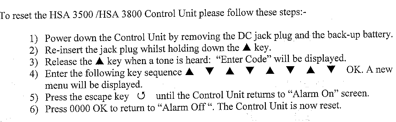

i have a Yale HSA 3600.
battery went flat today, I just changed them without reading the instructions!!
It has changed some of its settings all on its own!
I know the code to set and unset the alarm but i have forgot the P manual code, well i say i forgot it but the factory setting is 0000 and i cant remember changing it!
is there a way we can reset the factory settings? or is there a default code i can use?

Hi I have a HSA3600 the battery s whent flat so I put new one s in but its just saying rest control panel I do t know how to can anyone help please
which batteries went flat, and what did you replace them with?
I see yours is a 3600 which I think does not have a power cable
the 3600 manual does not include reset instructions
possibly it will work of you inset batteries where it says plug in the power cable

It don't have a power cable it's just battery s I pup in Duracell battery s it jus keeps saying rest control panel
