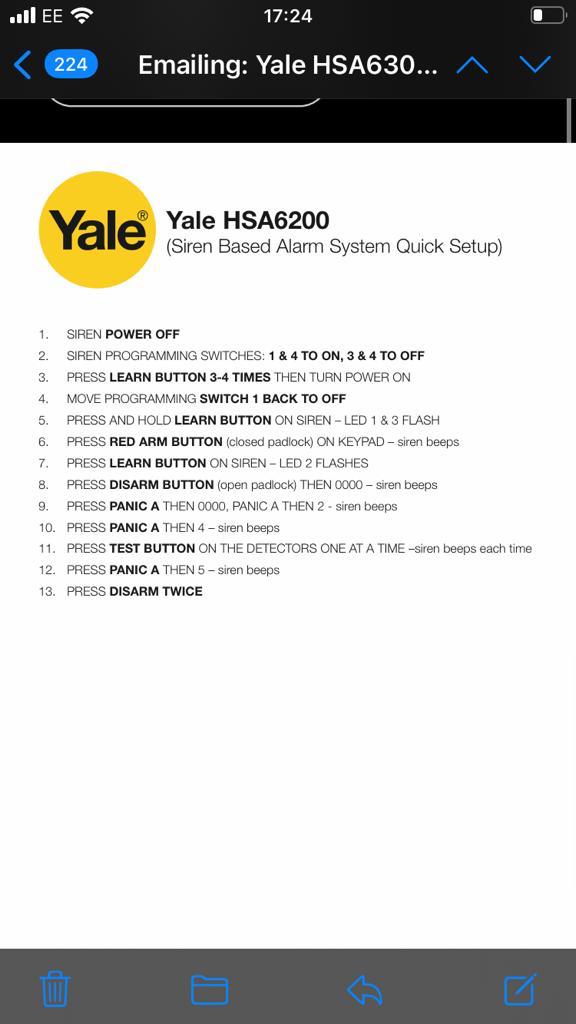

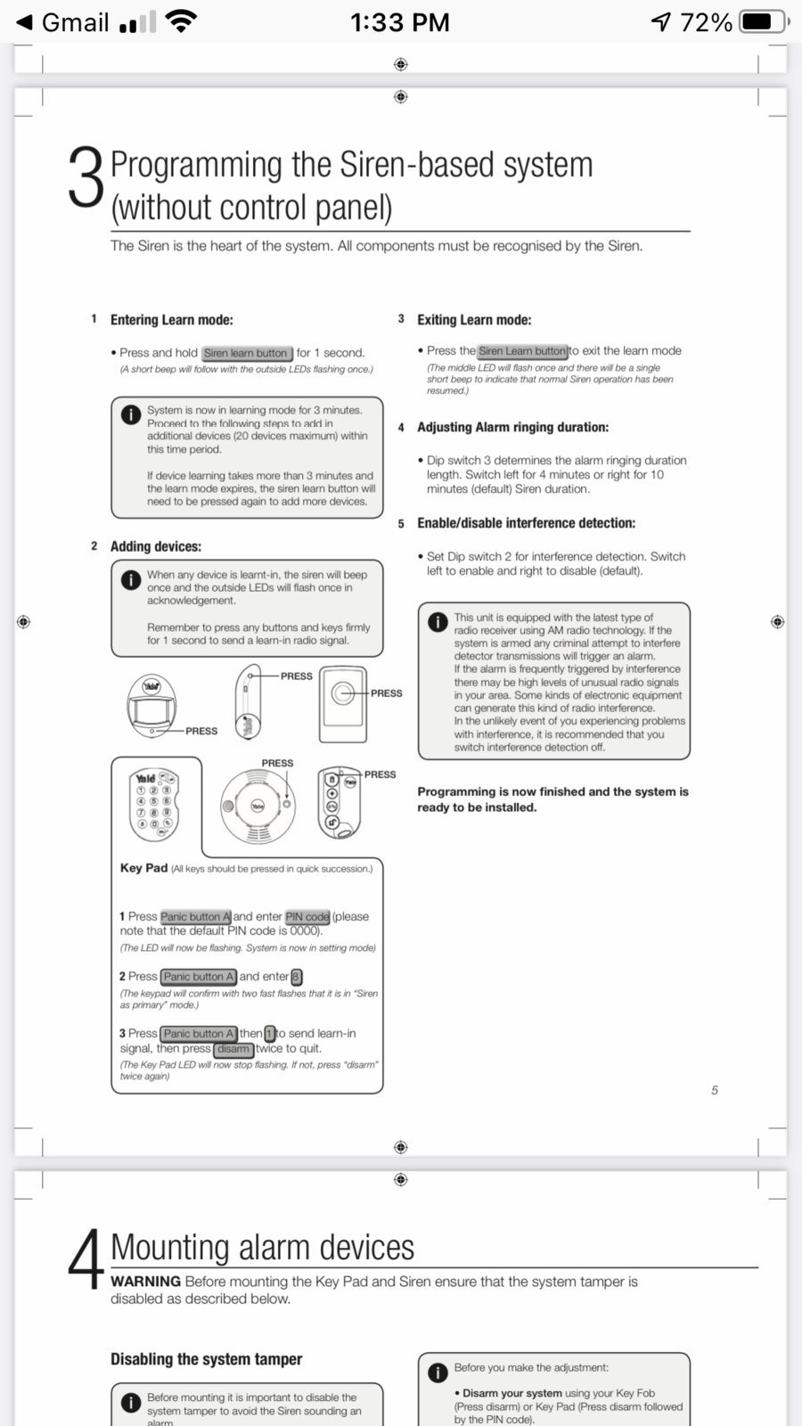

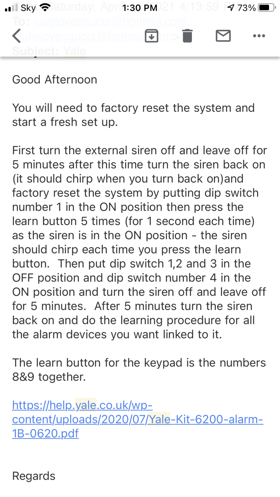

Yale HSA6200, too long before alarm goes off
I think the setup instructions reset the siren to factory settings at the beginning of the process.
Ah, you've got it.
You will need to learn in the other devices as well.
Yes I have motion detector and door contacts I think I just have to press the reset buttons on them all
thanks
