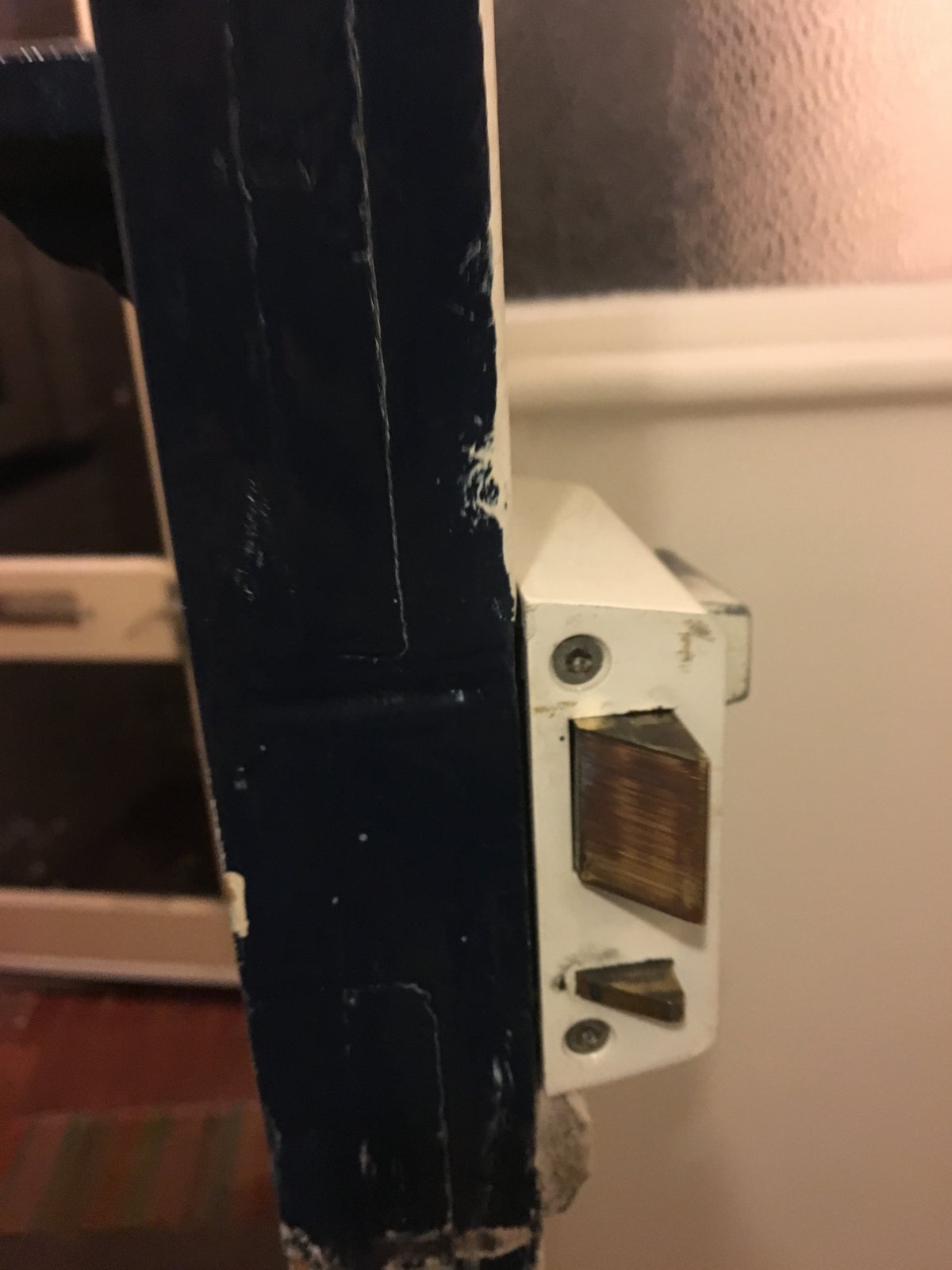

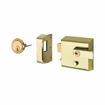

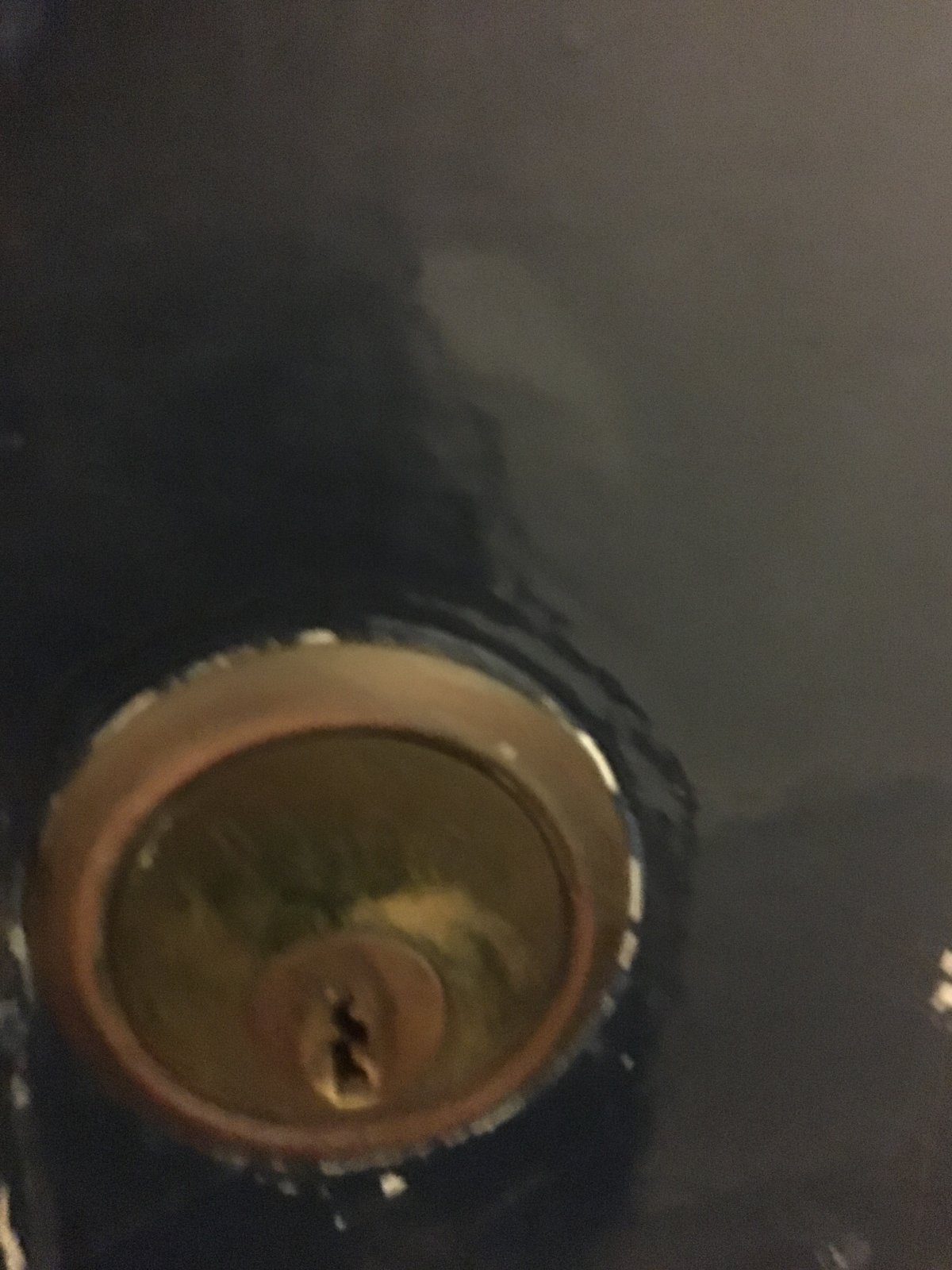

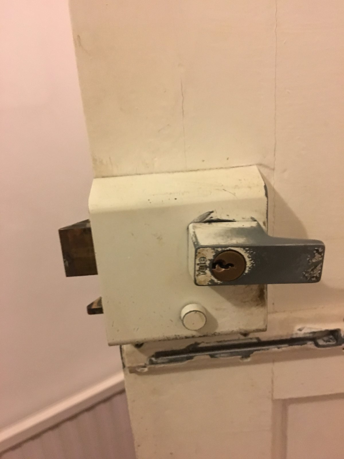

I want to know if anyone has experience of changing the locks on their own. Could any one tell me if the door lock is a nightlatch and if I should buy a 60mm replacement Yale latch. I already bought one and it didn’t fit - can anyone identify what type of night latch is this particular one. Could someone please help me?

What did you buy? Are you keeping same lock barrel or completely new ( new keys)?
yes it is a nightlatch
measure the distance from the edge of the door to the centre of they keyhole. It is most often 40mm or 60mm. But there are a few 50mm ones around.
You don't measure the case of the lock to find 60mm, the lock case will be bigger.
Please show us photos of your new one so we can understand why it doesn't fit.
Why didn't it fit?

It was big and I'd have had to cut a bit of the wood for the lock to fit. I think I just would need an exact replacement.
yes, that's true. Your new lock is a British Standard which is very strong, and has upgraded fittings.
But if you have, and can use, a drill and chisel, the new one will fit.

I don't know if Yale still make the same model that you already have. There are nightatches that don't have the big armoured escutcheon for the cylinder, but they usually have a more modern and larger "keep" that goes on the frame (this is the part that usually fails if someone kicks or barges the door) so they would need chisel work and new screws.

If you have just moved in, and want new keys, you could swap just the cylinder of your existing lock very easily, and the old keys won't open it.
https://www.screwfix.com/p/era-replacement-rim-cylinder-polished-chrome-33mm/8047t
Wow! Thanks, yes this looks like it's the same one. I will first check the rates of a carpenter. If it is too high, I will go for this. Thanks again.
