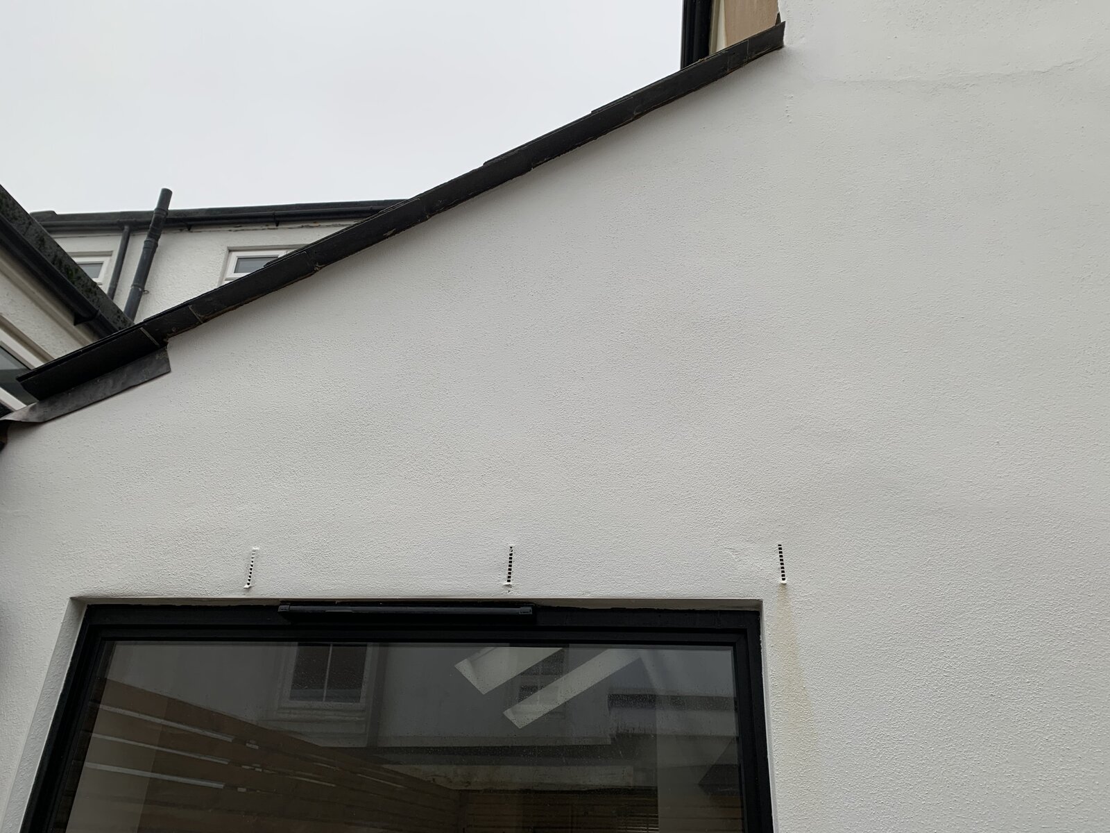

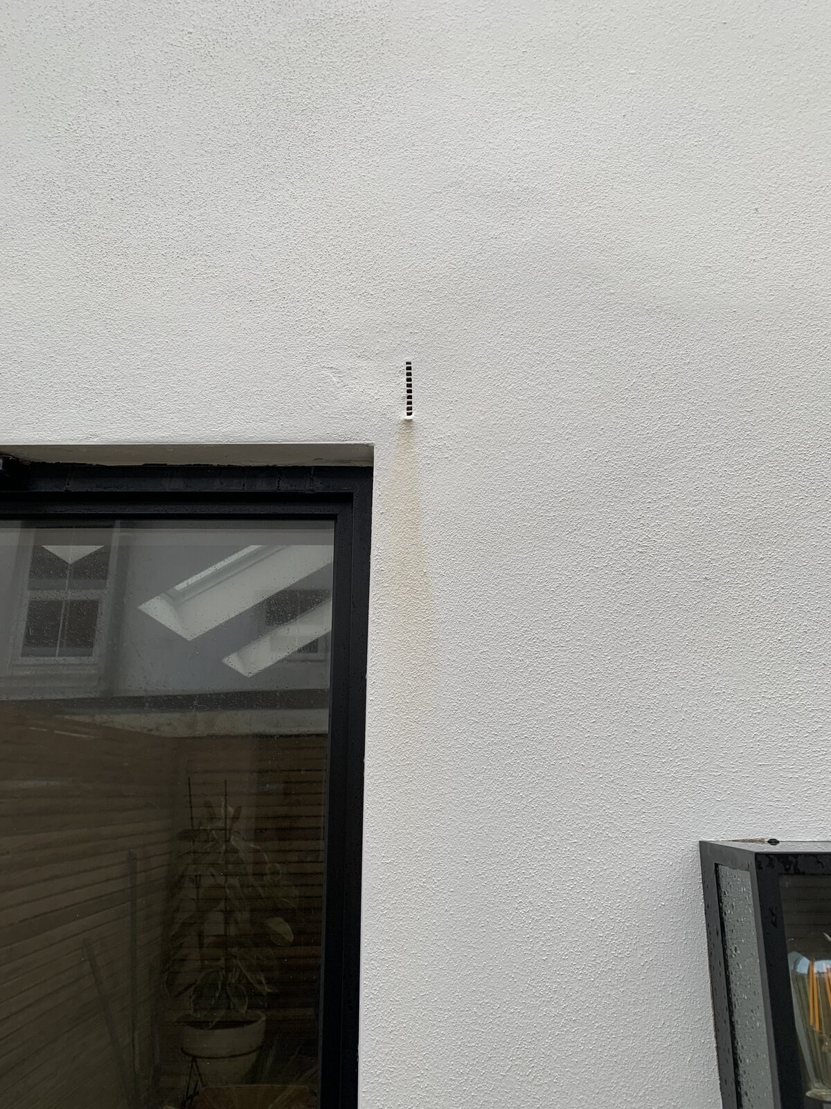

Hi.
I have a newly built and rendered external wall and one of the weep vents has some yellow staining below it. I was wondering what could be causing this? None of the other weep vents show similar staining.
Thanks in advance
That's disolved rust. There's perhaps a ferrous metal inside the cavity, and the residue is coming out the vent
I see. So I assume that will be from a wall tie?
Is this considered normal and the weep vent doing its job, or does it indicate that there is more water in the wall than there should be and therefore needs investigating how/where?
Thanks again
More likely it's from the steel lintel, as there's no cavity tray over it.
The fix would involve scaffolding, props and rebuilding over the lintel. Possibly replacing the lintel if it's in a bad way (probably not though).
How recently was it built, and have you asked the builder about it?
Only a few months old. Will ask the builder about it. Lintel is brand new.
Am noticing some faint water stains inside along steel beam, which extends back from this point too, so that is a bummer.
Definitely not expected. If they give you any waffle don't believe them.
Condensation within the cavity should be caught by a lintel tray, either ready-made or carefully crafted from a waterproof sheet with raised edges, and funnelled out of the weep vents without contacting the steel at all.
