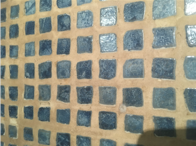

The grout on the tiled mosaic area above my toilet cistern has become quite badly discoloured, and I'd like to try and sort it, if possible.
Can I paint over the discoloured grout areas with some sort of white paint? If so, what type of paint should I use?
Thanks in advance.

It depends, why did the grout discolour so quickly in the first place?
Have you tried cleaning the grout with HG Blue? Please don't take offence- it helps to remove limescale and what HG refer to as "yellow stains" (read: urine).
Alternatively, bleach may work. When I used to smoke, the grouting in my bathroom was yellow- the bleach whitened it. Smelly but very cheap.

Not sure why this particular section has become so yellowed. It’s the that boxes the cistern in. I don’t smoke, and can honestly say I have not been urinating on it!
The unibond stuff looks like quite promising, though a lot of work on mosaic tiles. I will post photos when I’m finished. I’m using bleach on other areas, and it works quite well.

For future prosperity, epoxy grouts are less likely to be affected by cooking fats, pee, fags,etc, but they are more expensive to buy and work with.
My glass mosaic hob splashback has dark grey epoxy grout- I didn't want cooking fats to penetrate the grout. Ensuring that the tiles were free of grout residue took 4 times longer than if I had worked with standard grout.
